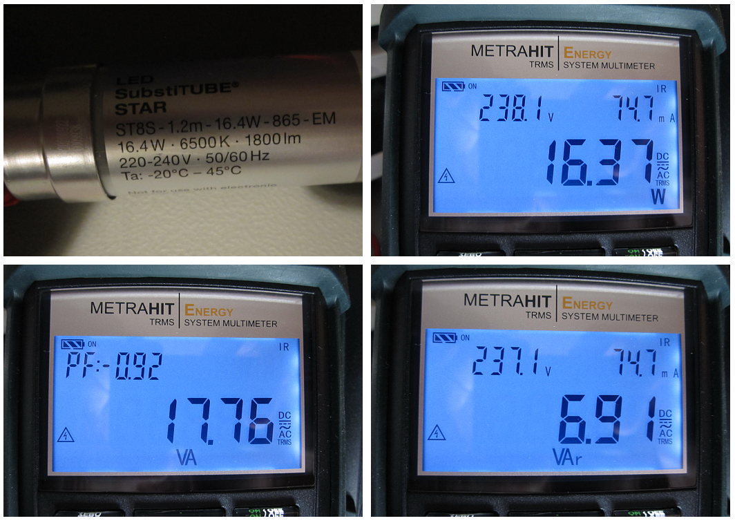

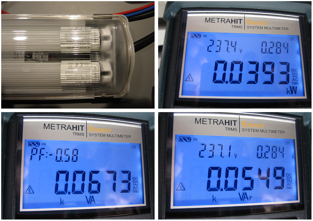

Here my two G13 (120cm) LED fluorescent lamps as a comparison: a cheap one from "Müller Licht" with 0.54 PF and a more expensive one from Osram with 0.92 PF. When I am not mistaken the Osram was the same price as the complete LED fluorescent lamp from "Müller Licht" in an IP65 housing with 2 x G13, 120cm; of course not the best build quality, but you get what you pay for... ;-)
Müller Licht G13, 120cm (4000K / 18W / 151mA)
with the worst power factor for LEDs I have ever seen: 0.54 PF
...and here the whole lamp with 2 x G13, this time with a power factor of: 0.58 PF for both LED fluorescent lamps in the IP65 housing:
OSRAM LED SubstiTUBE STAR ST8S, 120cm (6500K / 16.4W / "no info" mA)
with the 2nd best power factor for LEDs I have seen so far: 0.92 PF
Cheers!  ;)
