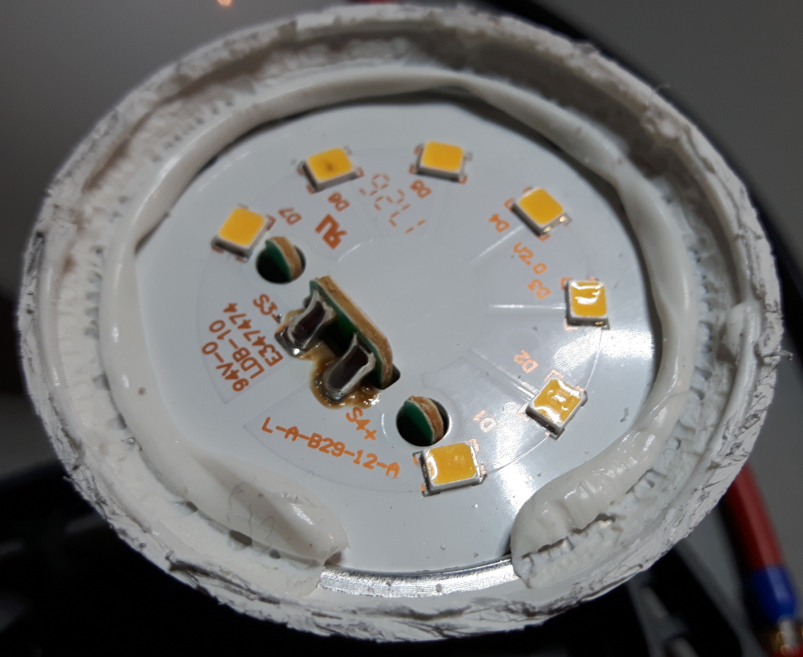

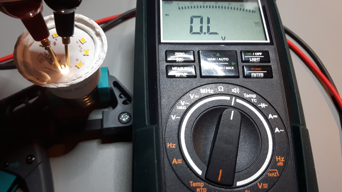

Just as an add-on to a message I wrote - this is my main equipment, together with a small saw not in the picture:
As for checking/repairing a dead SMD LED, you immediately spot the black dot:
My HMC8012 and Gossen Metrawatt do use > 6V in diode mode, so that I am able to test each SMD LED. Of course I don't see the voltage drop, but the DMM is able to light up any SMD LED, which neither my Fluke 289, nor my Keysight U1273A is able to do so.
If you wanna have it a bit easier, you may wanna invest in a ZEN50 from Atlas Peak, which shows the voltage drop of around 7.2V at 2mA or a little bit more at 10mA and so on.
You can shorten this procedure with the ZEN50, when only testing the (most likely) one dead SMD LED and all other start flickering immediately, so that you know, that you are on the right track!
That's it. Cheers!   :)
