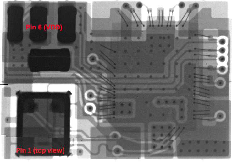

On the contrary, a dental head with mammo film can produce stunning resolution, as in you can clearly see the bonding wires inside SC70 and similar parts. Nothing accessible to the hobbyist rivals the resolution of mammography or single sided industrial radiography film. The focal spot is very small since they are normally used with a very short distance. At a longer distance capable of covering a larger sized cassette you will need exposure times of a second or longer but that is not a problem for inanimate objects.
You do need to take care not to overheat the tube though. There is typically no way to directly monitor the anode temperature.
Resolution isn't just a property of the sensor, but of the tube itself.  While the Faxitron doesn't have much penetrating power, you can get up to 5x magnification by placing the sample closer to the source.  That's the part that's hard to achieve without a microfocus tube, and from what I've seen, dental X-ray machines don't use microfocus tubes.
My favorite Faxitron shot so far is this one, of a 5x7 mm IC package.  The combination of 5x magnification and high pixel density at the CMOS sensor really gives you a good idea of what's inside:
A dental X-ray looks more like a 1:1 scale image due to the lack of magnification and low pixel density:
Yes, under the right conditions you could sort of make out bond wires, and I didn't mean to sound like the stereotypical EEVBlog "oscilloscope snob." :)  I would have been very happy with a dental system if I hadn't learned about the Faxitron on here.  But at the end of the day neither a dental-grade tube nor a dental-grade sensor is ideal for revealing high-resolution detail.  You might achieve comparable results with a dental tube and a high-end sensor, but the Faxitron's turnkey nature is really nice.  No hacking and mixing/matching of components is needed if you get the PC with it.
From what I've seen of Shahriar's interests, he would be best served with a plug-and-play specimen cabinet machine, or one like the benchtop unit in Fraser's post.
« Last Edit: May 16, 2017, 09:17:01 pm by KE5FX »

« Reply #11 on: May 16, 2017, 10:16:04 pm »
Yes that is impressive, if you can find one then a machine like that has definite advantages. I found that I could achieve magnification by placing the film further from the subject but in practice I rarely did that.
