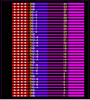

I am after the mating plug for the above connector. Or even a ribbon cable with the plug on it, which connects to all the pins. Just a one-off.

It occurred to me that I can get a little PCB from some cheap chinese shop, which (if the thickness is right) will just push into that connector :)

Final update:
I found someone making a cable to plug into the card but it is about £400, so in an hour I did a PCB
and for $30 got JLCPCB to make it. Gold plated.
It is a very expensive ARINC429 card (4x IN 4x OUT, from MAXT) which I picked up on Ebay for €150. I don't even know if it works and neither did the seller. I suspect it listed at several k $.
