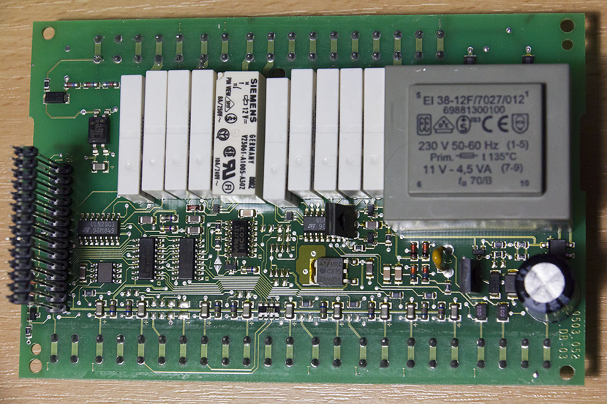

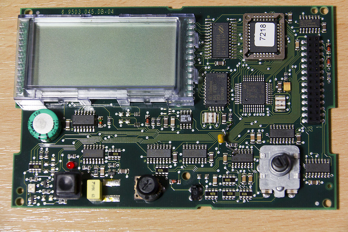

My "dead" unit turned up today. Don't know how dead yet as I've had time to take it apart but not to turn it on  :-/O
Mike was right, just a hole above an IR diode/phototransistor - the device looks like a SFH 7221
Steibel confirmed they do not sell the cable any more so DIY is the only option. They don't have the software either and, so far, the links above are dead. That probably is no great loss as I'll want to use a Pi or something similar for the interface.
Two board construction. Small linear PSU, 80C32 MPU, 4153 RTC with 0.1F supercap and 81C91 CAN bus controller are the main points of interest.

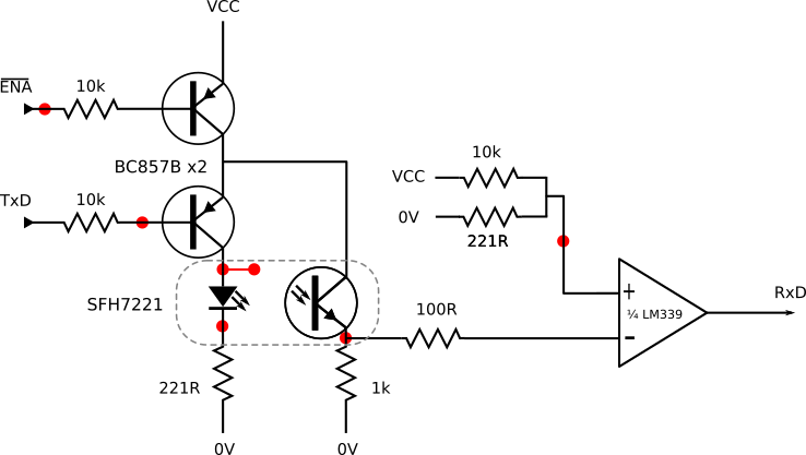

As a starting point I reverse engineered the schematic for the WPM controller I bought (I chose to do that board because the serial I/O is on fixed pins on the 80C32 microcontroller so it was easier to start at those pins).
The red dots are where there are odd vias that I have not been able to trace. They usually start out on a trace on the top of the board but don't connect on the bottom of the board (it is 4-layer) and the ground fill prevents me from seeing if there is a trace going somewhere on an inner layer but it's quite possible that they don't go anywhere - the circuit seems complete without adding anything.
The enable is one of the data outputs from a 74HC4094 serial->parallel shift register, I assume this is just driven by the controller, I haven't bothered tracing it further.
So, next step is to figure out what else I need to buy, apart from a £1 SFH7250, to make minimum order at Mouser :)
