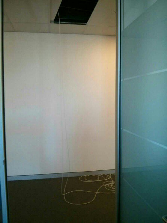

« Reply #16 on: November 02, 2016, 03:21:49 am »
And what happens today at my new office out of the blue?
NBN!  :o
Right the hell in front of my office door!
Time to check the T&C on that ISP plan I just took out...
The install guy recons it will still be a few months though.
