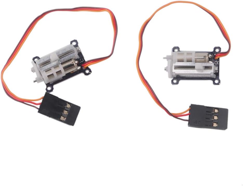

  • Posts: 7375
Re: need a reciprocating mechanism
« Reply #11 on: June 27, 2021, 02:53:33 am »
While the OP hasn't been back with some required info the little indoor R/C linear servos are about the easiest to incorporate into a design with minimal mechanical engineering or hacks needed. Costs on them are sub $10USD and all you need to drive them is a 4-6VDC supply and a 1-2mS pulse from anything from a 555 timer hack to a PWM out of an arduino. Some of the other screw options from AliX or evilbay are a bit more robust but you would need to do the drive electronics and position sensing too if you need accurate control.
