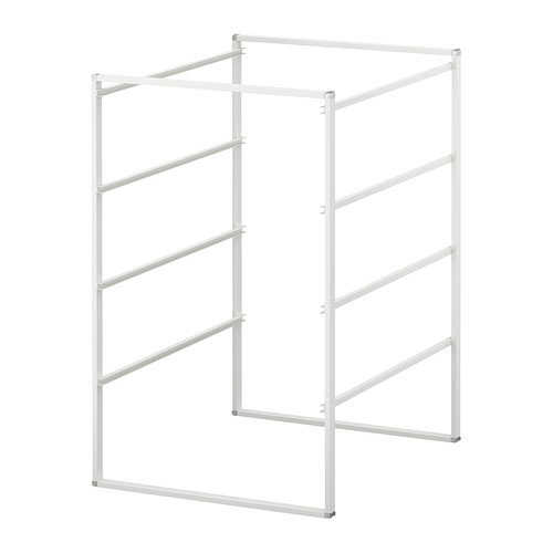

So went to Ikea for the 1st time. Found their scratch and dent aisle and they had a corner table top and side extension for $ 5.00 each. So got them and legs
Any Ideas for above desk shelving. Most stuff I saw not deep enough or not enough height between bottom shelf and table top. Wall mount shelves won't work due to large window in the way.

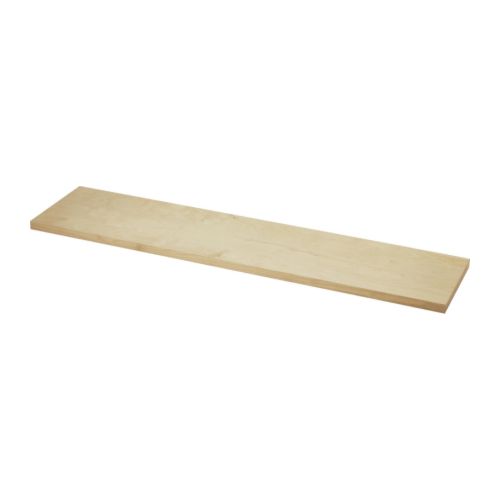

I found that stair treads work very well for equipment shelves. The ones I have are clear (no knots, cracks, or other imperfections) hardwood 1x12 with one rounded edge. I was lucky to find some 6 footers.  Stiff enough to not require mid span support, and can support anything I put on them with no perceptible sag. Downside is, they're not cheap.
I've never trusted MDF or any of the other processed sawdust products due to the effects of humidity meaning lots of sealant, cheap veneer, and easy to knock off edges.

Well I tightened the legs into their screw socket with channel locks.  That seemed to work
The legs I used:
http://www.ikea.com/us/en/catalog/products/70217973/

So far, I am having good luck with my workbench.  I used 3/4" MDF for the work surface and 1/2" for the shelves.  I built my bench in November.  I live in Florida so humidity is no stranger.  I don't foresee a problem as my 'L' shaped desk is made from melamine and I haven't had any problems with the wood swelling. :-+  It probably wouldn't be a bad idea to see about sealing with work surface.  I wouldn't want to have to replace it as an 8' by 34" piece of 3/4" MDF is a bit heavy and unwieldy to get through the house into the office.  Has anyone used any sealers on MDF and what are the favorite products?
Online pickle9000
  • Posts: 2439
Re: Need suggestions for bench build. Top of desk shelves?
« Reply #14 on: January 29, 2014, 06:25:20 pm »
Shellac based primer will seal it. It's expensive, smelly and will dry in 20 minutes. Avoid any water based products they will ruin the surface finish.
