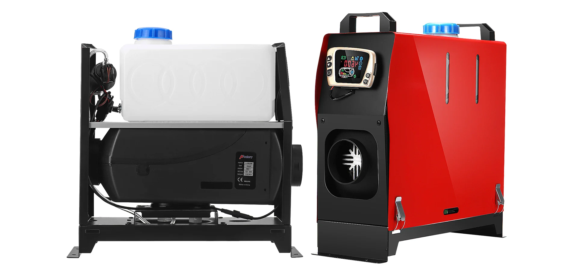

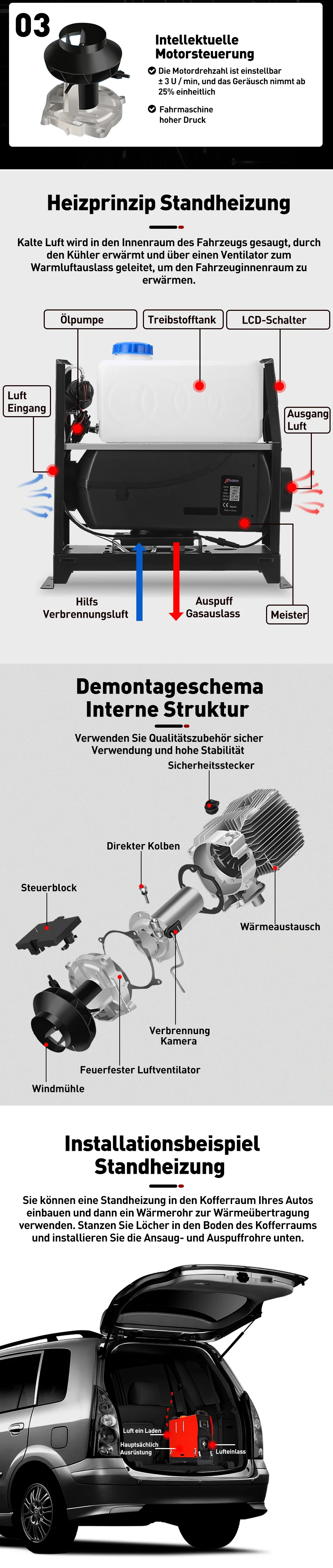

Offline Lord of nothingTopic starter
  • Posts: 1591
  • Country: at
Re: Recommendation for an Air -> Liquid Head exchanger?
« Reply #5 on: December 06, 2021, 05:25:41 pm »
 :scared: that is way to big for the small Heater unit. Also for the cute Gasoline Generator.
Here is a Picture of the Internals and the Heater:
https://ae01.alicdn.com/kf/H05e7501659ab41dbafb6400119ade4d9P.jpg
The Air Intake is horizontal and the Air Intake for the Burner also the exhaust is from the Bottom.
Both System are separate so no exhausts Gas will be blown into a Room.
As I mention before I would like use the heat who normally get vent outside use for what usefull stuff I will found. For that I would prefare an Air -> Water exchanger.
in the UK
non Eu mean I have to pay Tax + Import Fee,...
Why not look at auto parts?
Because I dont have any clue about them. The only way I come in contact are when I board the local Bus.  :-DD
I watched some German Speaking Video about there Heater and the sayed the exhaust have a diameter of 2,5cm. Its a thiney one.  ^-^
Can I use that without risking blocking to much of the Airflow?
https://de.aliexpress.com/item/32932744835.html
Thanks  :clap:
