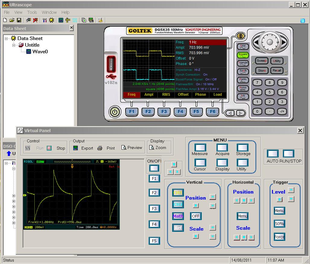

In playing with Mecha's and Marmad's software, I have discovered that my DDS3x25 does not faithfully generate certain waveforms (square, triangle and sawtooth) at low frequencies. Here's a "square" wave:
The maximum voltage is ~2 times what it should be and the shape will be nothing like it should be. Increasing the frequency, the amplitude is almost correct by 25hz
This happens with any control software (including Hantek's) and stand-alone on start-up when saved as the default waveform.
Oddly enough, it does not happen with sine waves. Sine waves have reduced amplitude at reduced voltage but maintain the correct shape.
Talking to Mechatrommer by PM, his DDS3x25 does not exhibit this curious flaw. Is this just mine or can anyone else reproduce this behavior?
« Last Edit: August 15, 2011, 02:06:00 am by torch »

« Reply #306 on: August 15, 2011, 03:11:03 am »
It all looks OK.
Your Rigol is probably spec'ed for a 50 ohm output. If so, an open circuit output will be double in voltage to the amplitude settings on the Rigol. That is normal for a 50 ohm output from a generator.
The waveform is OK to. You probably have the scope set to AC coupling, and that would be the correct waveform for AC coupling at 1 Hz squarewave.
Richard

« Reply #307 on: August 15, 2011, 03:34:55 am »
The Rigol has 1Mohm inputs. The Hantek was also set to 10 Mohm impedance. I was using co-ax (RG58/U) and tried it with and without a 50 ohm terminator. Yes, it affects the amplitude, but does so consistently. That is, this variation in amplitude:frequency occurs with or without the terminator.
Ding ding ding ding ding!!! WE HAVE A WINNER!
And I have egg on my face.  :-[
Yes, the Rigol was indeed set to AC coupling, and yes, setting it to DC corrects the waveform -- AND corrects the voltage fluctuation.
Thanks Richard.
