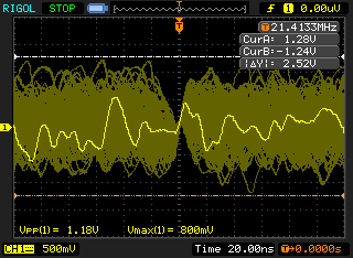

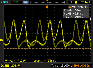

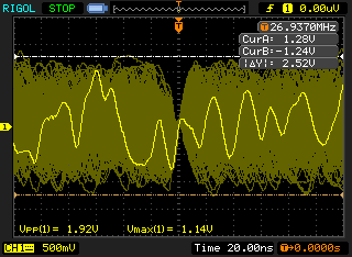

The following were taken controlling the output with the Hantek supplied software then the Goltek version. Frequency set to 20Mhz, voltage output set to 3.5v.  Input set to 1x. and the DDS 3x25 connected to a modded Rigol scope with a BNC cable and 50 ohm terminator tee.  "Auto" setting used then persistence turned on to show overall effect.
Hantek software, "white noise":
Hantek software, "gaussian noise":
Goltek software, "noise":
Goltek definitely seems less random at those frequencies. Hope this helps.

Is it important that the noise is completely random? Noise usually covers a wide range of frequencies, right? Two thoughts:
1. utilize Goltek's sweep function to cover, say 1KHz to 25MHz with a 1ms step interval and the "noise" (or a custom) waveform.
2. write some software to feed the DDS 3x25 with a constant stream of new waveforms from the computer to get around the memory limitations.

heh, Torch!
Thank you very much for going to the trouble of posting these.  You've made the device all the more tempting!

for random data like this it will boil down to memory size and clock speed. as far as 3x25 is concerned it has 4096 bytes memory and 200M sample/sec thats the limit when you put in your calculation. at that clock rate, you can put in some 100MHz harmonics (not random) and then add up lower freq harmonics etc and so on. if you calculate 4096 samples at 200MSps, that is a 48KHz repetition. from there you'll decide whether 3x25 can do the job or not.
as for goltek, it will "normalized" and "centered" the input data so you may get somehow sometime attenuated signal. agree with torch you may want the original hantek software to produce random data and send to 3x25 to see the difference.
