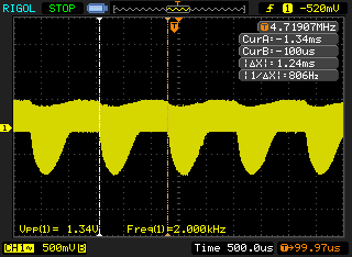

I am aligning a short wave radio and need an audible tone AM modulated on a carrier -- from around 9MHz to 17MHz. So I figure a 1000:1 ratio should be fine, giving me a 17KHz tone at the upper end.
In ArbExpress, I generated an arbitrary waveform using the expression
Sin(1000*w)*(1+0.75*Cos(1*w))
to generate 1000 sine waves, the peaks of which form one overall sine wave. Zooming in on the waveform within ArbExpress confirms the waveform is as expected:
When I load it into the DDS3x25 via Goltek, the overall shape appears correct (goltek set to 20 hz):
However, zooming in a bit, something doesn't look right -- instead of sine waves, it appears to be an underlying modulated wave:
Zooming in further confirms this. I do have the right number of pulses, but they ain't sine waves, They are groups of square waves that gradually average out into the overall shape:
I'm not entirely sure what is going on here:
I suspect those random drop-out glitches are something to do with the Rigol and timing. If I zoom out still further the waveforms appear fine again. It only happens at that one setting.
Is this some sort of glitch with Goltek or with the Hantek? Or am I doing something completely wrong?

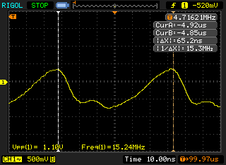

I got it working -- sort of. Not really a sine wave, and a bit jittery, but I think it will be accepted by an old tube radio:
The superimposed audio frequency sine wave has similarly jittery amplitude, but should work nonetheless:
So it will work at 17KHz (for an RF of 17MHz)
However, I still have the original problem at 15.26KHz, which I need for aligning the 15,260KC point.

ok i saw your csv file that you emailed me. the problem...
"instead of sine waves, it appears to be an underlying modulated wave"
due to aliasing resulted from downsampling made by goltek from unsupported 10,000 pts to 2048 pts which is the managable value by 3x25
"They are groups of square waves that gradually average out into the overall shape"
due to you are asking 3x25 to run at very slow sampling rate (40KSps). coupled with the kind of downsampled points will generate that very bad (worst) stairsteps, its the nature of DAC inside the 3x25.
"I suspect those random drop-out glitches are something to do with the Rigol and timing"
did you activate peak detect mode? if not then this is common problem with discrete sampling DSO... signal aliasing, is when the dso is sampling at the rate less than 2 times of the signal frequency. thats why Mr Shannon worked hard on this and produced his theory long time ago.

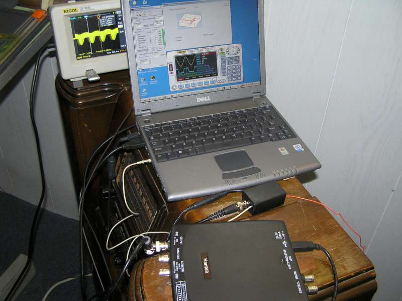

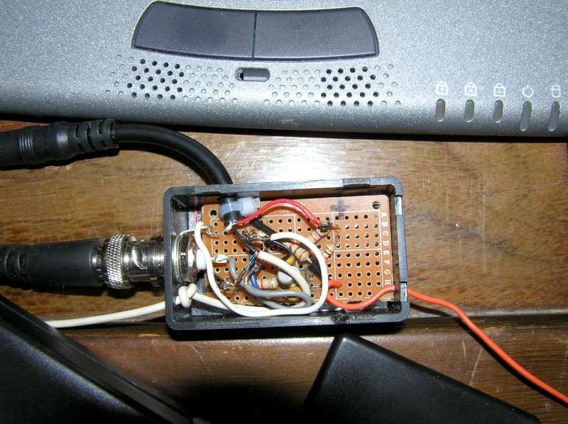

I have poured through Mechatrommer's files and explanations and while there are still some aspects I don't fully understand, most of it makes sense. As others have said, this is a very versatile piece of equipment for the money, but it is a fairly cheap piece of equipment and has more limitations compared to expensive professional grade equipment.
What I am trying to do just can't be done with 2048 data points. Mecha's examples at other frequencies do generate a decent signal, but unfortunately those frequencies are too far away from what I need. For example, the 19 meter shortwave band only spans 15.10 to 15.60 MHz, so 16.67 MHz just won't work as an alignment signal.
The long and the short of it is that the DDS 3x25 generates a good AM moduated wave at medium-wave frequency, a perfect SW carrier wave or a perfect audio wave, but just cannot produce a good AM modullated wave at all SW frequencies. Time for another solution. I was sitting there staring at things when my eye caught the headphone output jack on the small laptop I use to run Goltek. Now, the sound card can't generate a SW carrier, but is great at audio frequencies. If I could combine the two, I could let the Hantek do what it does best and let the laptop handle the audio. I didn't have a suitable audio transformer at hand, so this is what I came up with (modified from a schematic I found on the internet):
It only has one NPN transistor so it actually only produces a half-wave:
And the carrier, while nearly perfect on the breadboard ended up a little distorted when soldered together, but it's at the right frequency and seems close enough for the tubes:
It fits in a tiny project box. I cut the cable off an old set of earbuds for the audio feed, scavenged a wall-wart for the power supply with an in-line DC jack cut off another cable previously scavenged for another project:
Good thing it's a large floor model radio with a large, flat top! For the audio signal, I d/l a freeware program from http://www.dr-jordan-design.de/signalgen.htm. The combination generates a clear loud tone at the desired frequency with little to no cross-over. Perfect for what I needed to do. I set the tone at 800Hz and can quickly type a new carrier frequency into Goltek as I flip back and forth between the bands for the various adjustments
