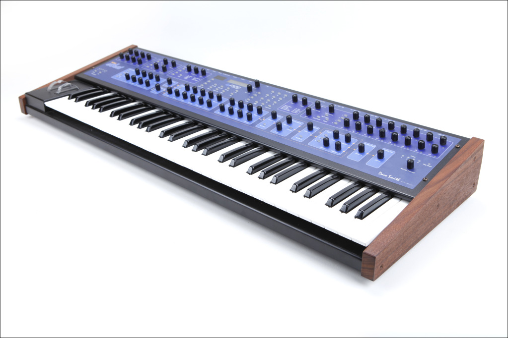

« Reply #4 on: May 31, 2012, 01:32:16 pm »
I have one of these (Dave Smith Instruments Poly Evolver) and it has about 70-80 encoders. After a while (even with limited use) they start going bad and start getting really erratic. I can treat them with DeoxIT and that does work for a while, but in the end they get erratic again.
A few hundred of those synthesizers (and the related Prophet '08) were made and they all pretty much ended up with malfunctioning encoders. It probably cost the (small) producer quite a bit of money to placate furious customers (and some image damage to boot). They've switched to pots a while ago, even though encoders (arguably) make more sense for this type of application.
