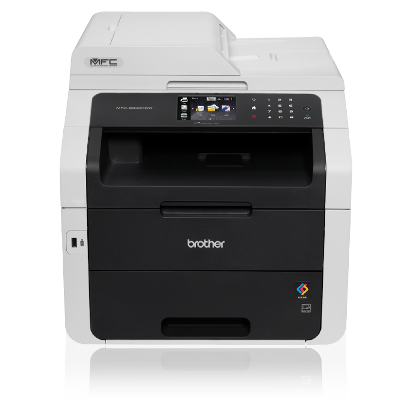

When scanning books on top of a flatbed all-in-one printer/scanner, you have to flip the book around every other page.
Why don't scanners have a "flip every other page" option when creating a PDF?
Or are there some that do?
The idea that I have to edit the PDF after annoys me.
And are there any scanning apps that are good enough to scan technical stuff with? Like they'll get the grayscale stuff and graphs right?

Just change your scanning behaviour :)
Scan the left page, then shift the book so you scan the right page. A general cutting of the format afterwards is easy.

I can't, unless the top comes off. It doesn't. It moves up by about an inch, that's it.
