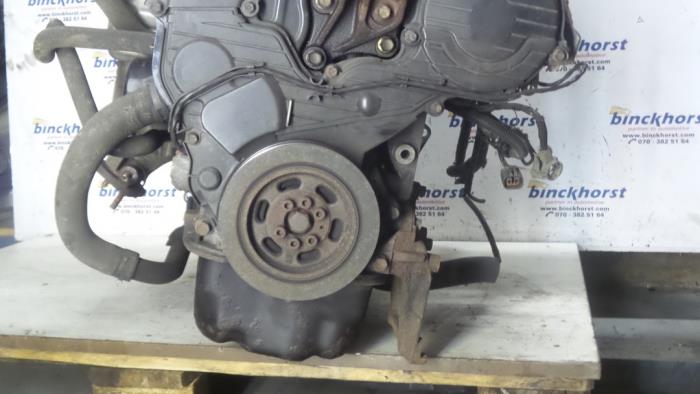

IMHO the Nord-lock video is doctored. Just look at a car and how many bolts are put into the engine block alone without a washer and they won't run lose when torqued (and some bolts do not require a lot of torque; like 40Nm to 60Nm ) to spec. It is just a matter of good engineering. What kind of worried me on my previous car where the 6x M6 bolts holding the crank shaft pulley in place while needing like 40Nm of torque on each bolt. They never ran lose though.

Its an official test: DIN 65151, the bolt is hit directly with shear load vibration. They show initial preload is 75Kn, I guess that is M12 bolt? then it would be 180Nm of tightening torque.
If you have a setup with enough clamping force to prevent sliding movement, the bolt shouldn't easily loosen: https://www.boltscience.com/pages/vibloose.htm
In the case of your crank shaft pulley, I assume its balanced well, and the forces are opposing each other, that the shear load on those bolts is minimal. But yeah, not all automotive fasteners will have loctite or washers at all, surprising to me too.
