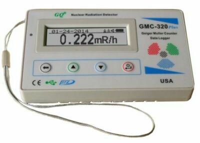

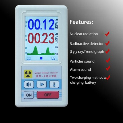

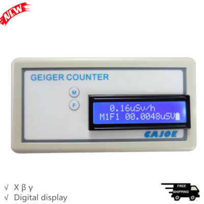

I have always wanted to buy a Geiger counter or radiometer or other instrument that measures such incidents. I was also thinking to build from schematics and simply buy a Geiger–Müller tube. However, I'm at a loss as to what kind of instrument will do the job. Obviously they cover different types of radiation, calibrated to handle different level ranges, and so on. So what does someone buy? On a budget... Here are examples, many of which are under $100, some under $50. Anyone have experience with something reliable and does the job and good value:
https://www.ebay.com/itm/Geiger-Counter-Nuclear-Radiation-Detector-Beta-Gamma-X-Ray-Dosimeter-Monitor/163564446468
https://www.ebay.com/itm/GQ-GMC-320-Plus-Nuclear-Geiger-Counter-Radiation-Detector/133436410612

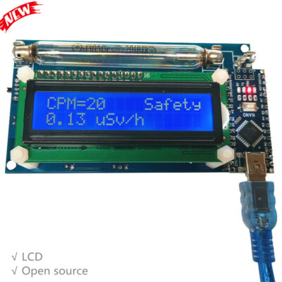

Open Source assembled kit with tube:
https://www.ebay.com/itm/Geiger-Counter-Radiation-Detector-Module-with-LCD-Display-Open-Source-DIY/114017690530
https://www.ebay.com/itm/Handheld-Geiger-Counter-Nuclear-Radiation-Detector-Meter-Digital-for/114017691137

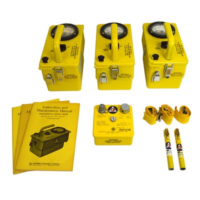

And then there are tons of these Civil Defence Geiger Counter kits. I'm not sure what the different components are. I see a "charging box" and some long cylindrical tubes. Can anyone explain a bit about whether these are any use for the type of radiation leaks we are seeing or is this for another purpose:
https://www.ebay.com/itm/CD-V-777-Vintage-Civil-Defense-Radiation-Fallout-Detection-Kit-Set-w-Box/163488683740
And short of a nuclear catastrophe can we use any of these for fun educational experiments like measuring basement radon leaks, smoke detector radiation source, marble countertops, various rocks and so on?
There is one more conclusion which is really none of the above instruments are worth buying, some may be gimmicks and some may be too limited in scope of use or type of radiation capable of being detected. Since alpha would be almost impossible to detect unless you were directly on top of the sample, and beta would also be limited in penetration and you'd have to be very close, that leaves Gamma/Xray and Neutrons. Of course you'd still have no idea what isotope was causing the radiation (unless you knew details on the source) but at least you'd know what and where.
Let's just put it this way: If you encounter a nuclear incident that gets detected by one of those you are f***ed. A GM tube doesn't discriminate between different types of radiation, it is charged to a point where any extra energy that gets put in triggers a discharge of the entire tube-> that's why they are so pouplar and why they "click": The discharge is strong enough (and uniform as the entire tube discharges every single time) to power a loudspeaker. The only way you would detect something with a GM tube is when it significantly overpowers the natural background radiation->no bueno for you.
If you want to detect such events you need something that can discriminate between ions with different energies: That's a scintillator counter, and it is effing expensive (basically a orange sized monocrystal mounted on top of a photomultiplier).
Back to your GM counters: If you want to play around with it and see what emits radiation they are optimal, but you won't be able to detect radon and smoke alarms: All Radon isotopes decay via alpha radiation, the same goes for the Americium used in old smoke alarms: Only alpha, because they needed something that can ionize smoke particles-> let's just shoot them with really fat positive ions and hope they stick. Charged ions-> gamma is out. Alpha, because helium nuclei are way bigger than electrons.

I don't have the spare $ for such a toy, but if I did I would get a Gamma Scout ($400) or an Automess 6150AD ($400). These are the units used by bionerd23 in her videos at Chernobyl, and both have the ability to measure different types of radiation (gamma, beta, and alpha) either built-in (with the Gamma Scout), or using accessory probes (for the Automess).
Cheap geiger counters are generally gamma only, which has limitations since the "hot particles" ejected during a meltdown are alpha emitters. Another important point is that the counters that read in Rads or Rem are not going to be accurate with different isotopes. Dose-equivalents can only be calibrated for specific isotopes and not for unknowns. With unknowns, you are just looking for counts per minute as the detector cannot differentiate between events that trigger a discharge in the GM tube.
Scintillation detectors would seem to be less sensitive and less desirable, but the energy of the particle does change the output, so they can be built as spectrometers for profiling different isotopes.
Yeah, but you don't really need to measure alphas as they are only extremely dangerous when they are airborn and their concentration would be too low to be detected by normal alpha counters (unless you point it at a HEPA filter with a suction fan behind).

I've read that the civil defence ones are extremely low sensitivity, to the point that if the needle moves at all, you're already in big trouble.

yes the idea is that they are reliable and allow for soldiers and relief workers to avoid areas that will certainly kill them in order to perform other useful operations. If those are used society is probably so screwed that long term radiation poisoning down the line ending your retirement early is the least of your concerns. Not to mention its going to be cheap since no one wants to use it.
Most of the Civil Defense instruments using ionization chambers which are much more useful for detecting immediate hazards where a Geiger counter would have saturated resulting in a measured level which could be orders of magnitude low.
On the other hand, a Geiger counter is exactly what is needed to test air samples like coppercone2 mentioned.  With some care, you could check your basement for radon with one.
But you would be in even worse trouble with a Geiger counter which unknown to you is saturated producing an erroneously low measurement.
Remember at the start of Chernobyl where the radiation reading was "only" 3.5 rems per hour?  In a similar incident in the US at Stationary Low-Power Reactor Number One, when emergency personnel showed up with ionization meters, they backed off because they got a true reading of the incredible radiation hazard which was present.
