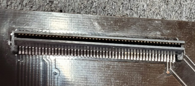

I am trying to source a replacement Board to board connector for the Oupiin 2348-100G00DP1T Board to Board Mezzanine Connector. Mfg Says Discontinued.
Data Sheet..
https://www.oupiin.com/download.html?act=gTData&dID=4146
I did find one supplier that claimed they had
https://www.dghecon.com/productinfo/2190163.html
after discussion they did not have the mold for 100pin only 80 ughhh.
Alternative would be to replace the Oupiin Connectors and use headers. They use them in the Board stack but cannot seem to find the source for like kind either. I have looked very close at the Header connector no mfg markings and Stack height needs to be 8mm.
Anyone? ID These Headers?
Male
Female
Thanks.

Have you checked that just standard 1mm SMD headers will not fit the footprint?

Two 50 pins and a few minutes work with a Dremel.
Align them for soldering with a couple of lengths of the pin headers suggested by thm_w.

Would one of Samtec’s 1.0mm pitch headers work? They claim to have up to 100 position models.
