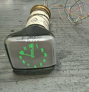

Offline Alex Eisenhut
  • Posts: 3549
  • Place text here.
Re: This electons flowing rubbish
« Reply #6 on: March 01, 2021, 04:22:12 pm »
How do these work?

Offline Gyro
  • Posts: 10172
« Reply #11 on: March 01, 2021, 07:48:11 pm »
How do these work?
Ah, those are Cathode Rays  ;)

Offline Cyberdragon
  • Posts: 2676
« Reply #12 on: March 01, 2021, 09:00:01 pm »
How do these work?
You confuse rays with beams, D! Minus! I'd give you an F, but that would mean seeing you in summer school. ;D
*BZZZZZZAAAAAP*
