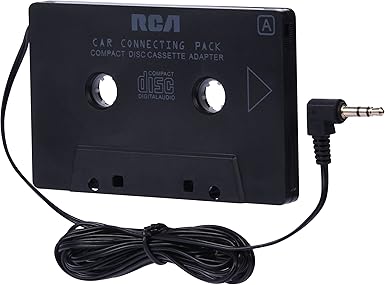

There is no mp3 capability as far as I'm aware, and these typically didn't come with line-in (this is a major complaint regarding Panasonic of the era). The tape decks are mechanical, no auto-reverse and no Dolby of any kind. With respect to using line-in or Bluetooth, I thought of using a cassette adapter (I have a few from when I had a tape deck in the car). They have cassette adapters with a 1/8" audio jack that I can plug in, or some now come with bluetooth built in to the cassette. I believe that would be the easiest way around it, not ideal but if I want to stream something to the box that may be a way.

Thanks for the suggestion... I'm going to have to look at the schematics and see what feeds into the main amplifier circuit (from either the radio or cassette) and just piggy-back an input source on that. I guess I need to make sure the levels are ok as I don't want to overload the circuit with a line-in that is potentially too amplified. Alternatively, I have seen these and I'm pretty sure I have a wired one somewhere that I used to use in my car a while back:
https://www.amazon.ca/Universal-Bluetooth-Audio-Cassette-Receiver/dp/B06XDDHXRN
... and this one I have, will give it a try ...
https://www.amazon.ca/RCA-AH600N-Car-Cassette-Adapter/dp/B000BUN79K
I also have a BlueTooth receiver that I could technically connect to the wired cassette adapter, making it accept BlueTooth although it won't look as clean as the all-in-one BlueTooth cassette adapter:
