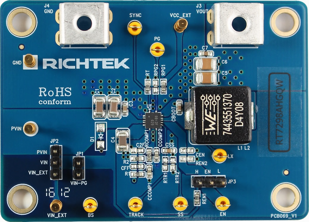

According to famous Russian site, that would be a MC78FC50HT1G. This seller has a picture (see attached) which confirms the 0M marking.
Another proof that the batches of components ordered in bulk by other manufacturers may have cryptic labels or no labels at all. Had Western Digital My Cloud Home NAS to repair where DC step-down ICs had something like 0B=0L on them. And exactly same IC's on two same model boards from different batches had different labels. Seems they use IC batch number instead of recognizable label.
That's a Richtek part, more precisely RT7298AHGQW. The image there confirms it. Only part of it is the ID code, the rest is the batch/lot code.
The following users thanked this post: ebclr, Yamin
