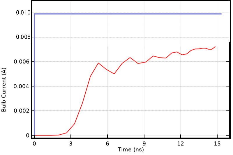

Can you zoom in in the first ten nanoseconds, to see how well they match?
We can’t expect them to match. Transmission line theory cannot be used to model the initial 1m/c delay. I mentioned this in my previous posts.
We both know they do not match. I just wanted to see if you can show just the first ten nanoseconds to see how much they do not match.
(This, as well has been debated in previous posts - but it would be nice to see it graphically)

« Reply #884 on: January 10, 2022, 04:23:48 pm »
First 15 nanoseconds

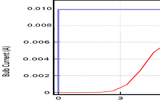

First 5 nanoseconds, where the magic happens:
