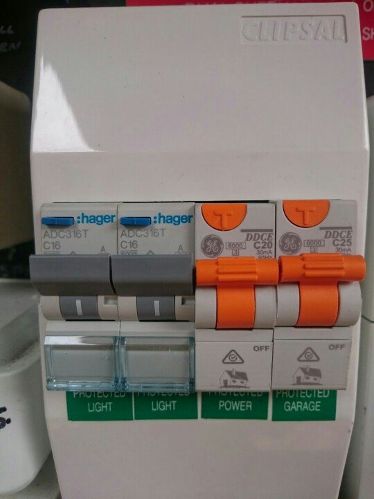

RCD's when they trip are performing out an important function in helping minimize the risk of electrocution and fire but can some times be seen as a nuance if the fault is intermittent and you have one RCD on the supply to all circuits in a distribution panel. So when it trips you loose everything and you are left in the dark.

In the UK it is now a minimum requirement for new installations that a split load distribution panel is fitted where by there are two 30mA 0ms RCD's in the panel so the properties circuits can be split across the two. Idea being when an RCD trips your not left completely in the dark.
The next stage on from a split load panel is to use RCBO's for each individual circuit. There is a higher installation cost (costs of RCBO's are dropping) but has the advantage of only the circuit with the fault present on it trips out. This helps with finding the source as you only have one circuit to check and all the other unaffected circuits carry on as normal.
Just changed the one master RCD to 4 separate RCD's (two lights, two power). So now lights won't go out if an appliance fails for trips it when plugged in.
Certain plugpacks I had often tripped our existing RCD, the Makerbot and the laptop ones.
Our RCD was failing every few hours when we got back from holidays, no problem now it's changed over to separate ones.
Source still unknown but the electrician said that old model had a history of unreliability.

What's all this about:
I know they can do proper CU upgrades in Oz. Did a registered electrician install these?
Offline EEVblog
  • Posts: 38825
Re: RCD's (brought to mined by Dave's tweet)
« Reply #8 on: January 14, 2017, 01:13:44 pm »
Yes.

16A for lighting circuits, he must have checked it is all in at least 1.5mm.
Looks like whatever was handy in the back of the van.
