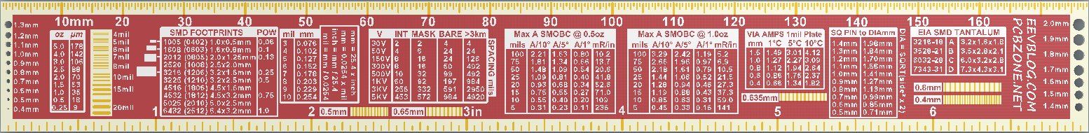

Is that a 0603, still learning the size aspect of smd
Hard to tell from a picture, but I think it's 0805 and the 4 parts to the left of the fuses being 0603 and the 0 ohm resistor marked '000' being 1206.
But if you're in doubt, just measure the length and width with a ruler or even better a calliper.
Here's all the standard SMD resistor dimensions in mm:
The dimensions are also shown on Dave's µRuler: http://www.eevblog.com/projects/uruler/
But you don't have to work with SMD's for long before you learn to easily tell the difference between the most common sizes like 1206, 0805 and 0603 just by looking at them.
