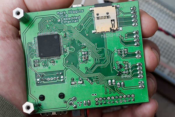

Offline TheDirty
  • Posts: 440
Re: What's your biggest PCB mistake?
« Reply #4 on: November 18, 2010, 06:09:13 pm »
Most of my boards are home made, so it's never much of a problem for me, cuz I can just fix and re-etch a new board, but I've made a lot of boards and errors are pretty uncommon for me now.  I also make a lot of breakouts, so I can breadboard everything before hand and footprint errors would come out then.
The ones I have sent away for, the biggest error I've done was forgotten a diode to separate the backup battery for the RTC, so I had to scrape off some solder mask and cut a trace to solder I diode in.
Bottom right, the SOT-23 that's at a 45 degree angle.
Mark Higgins
