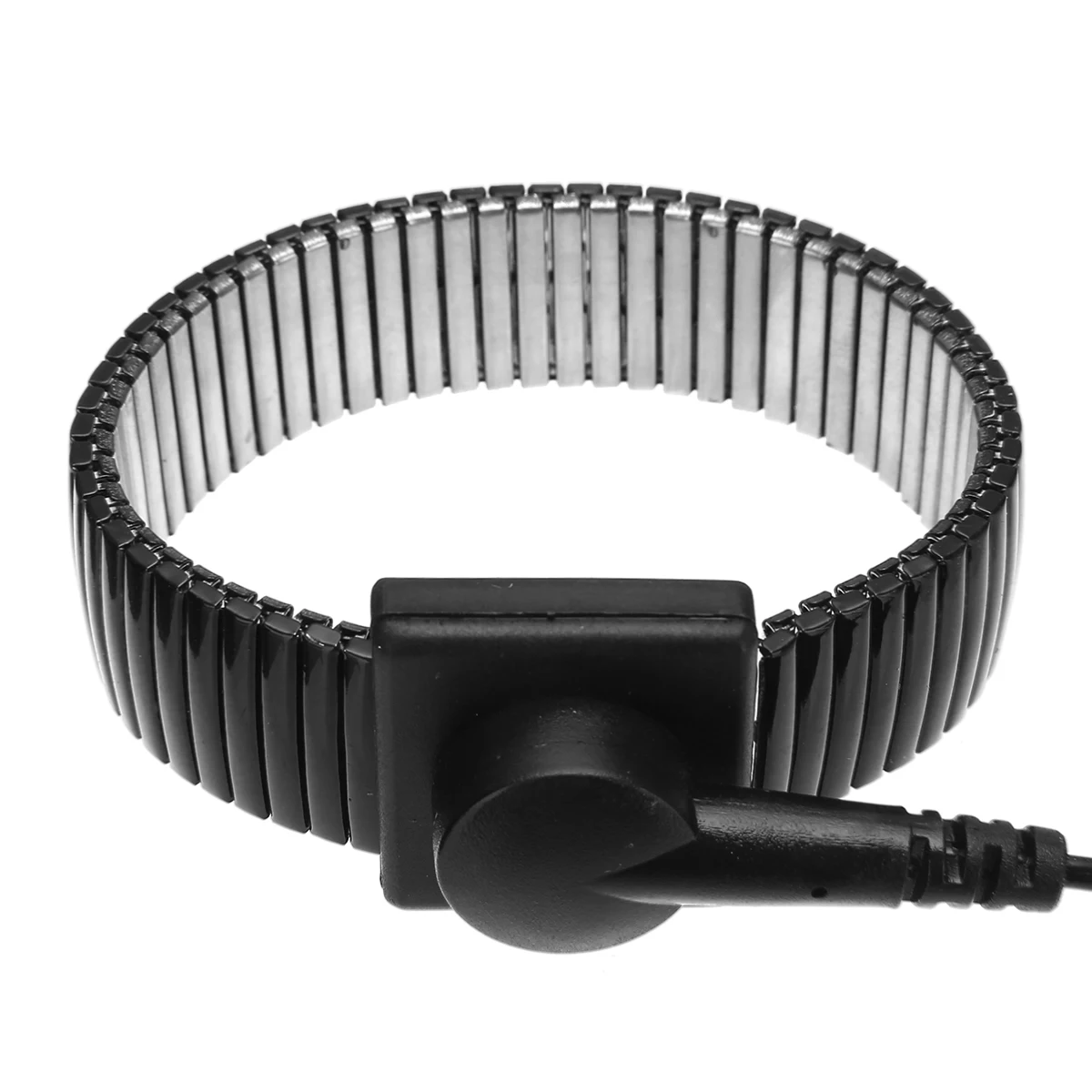

The big problem with the “I’ve never had ESD damage before” is that you don’t actually know that; a lot of ESD damage is not such that it causes immediate, complete failure, and the discharges sufficient to damage sensitive electronics are far smaller than anything we can see or feel. Often, a discharge just degrades a part, such that it no longer performs to spec, or damages it in a way that it fails down the line (and then we attribute the failure to random failure or age, and not the causative ESD event).
ESD mats are cheap, and a great way to protect the workbench anyway, so IMHO there’s no excuse to not have one.
I have had ESD damage before, and let me tell you, it is a wonderful feeling when your devices suddenly start working after the ESD mat is installed. I also recommend an ESD chair (even if it is not grounded), because chairs are probably the number 1 source of ESD, and an ESD chair cannot build a charge.
I agree about getting an anti-static mat. And if you work on customer products, get a wrist strap as well. I won't touch anything that goes out to a customer without wearing an anti-static wrist strap (and work on an anti-static mat). I learned about damage due to static discharge the hard way a couple of decades ago. I have a couple of these from a reputable brand:
