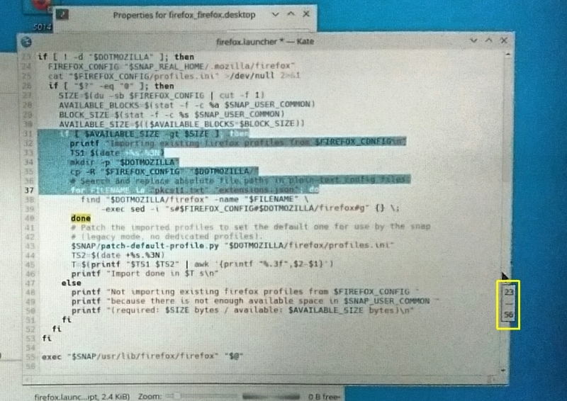

Everytime they release a version of Kate (text editor) more bloat and annoyances appear. This new one has this stupid welcome screen. I don't open it to stare at a welcome screen, I open it to start typing.
Last year I found out one of the annoyances, it was the called the minimap, then the tabs, the toolbar with the hamburger icon taking up room.
Now this I find really annoying:
Numbers change as I scroll and I find that distracting.
I don't know what it is called and turned most of the settings off to do with the scrolling.
