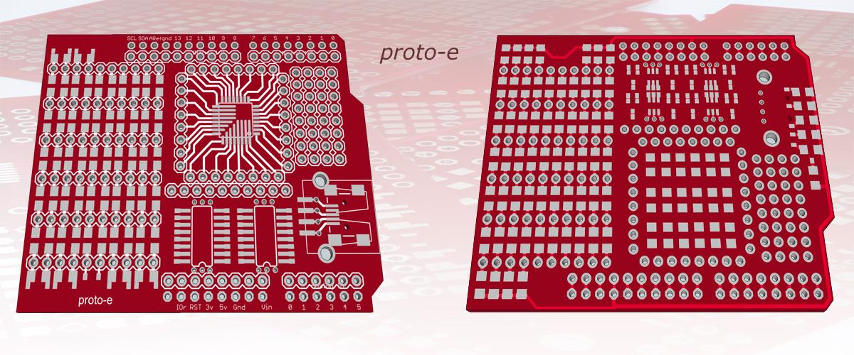

Fresh CF campaign on Indiegogo.
http://igg.me/p/1177304/x/10232118
We offer you prototyping PCB. A bit different one.
Protoboards on market are mostly for TH (Through Hole) components and off course it's also supported here.
But you can combine it with other components since there is lot of SMT and one TQFP32 soldering place.
And pinout is fully compatible with Arduino UNO R3 boards so it's a solid start for any new Arduino shield.
The fact is... you can also make your 'duino compatible board using this PCB.
Please take a look at the campaign and share this link with other people.
All contributions, comments, suggestions and questions are welcome.

Interesting board, but I find it a little cramped. If you look at your first photo, do you think you would be able to solder a wire between the DIL socket and the 7 segment display without melting one of them?
Also the QFP breakout having only one hole per pin is a bit too little. At least two would help. Or, if you don't want to put two holes, put there a larger but solid pad (with no via) to solder things on. Like this I would end up soldering e.g. a pull-up resistor, a cap and a wire to a button to the same pad anyway because it won't all fit in the hole.

Hi janoc,
Thank you for your interest about our PCB.
1) This is two sided board and you can easily solder wires on bottom side to connect 7 segment with DIL or any other component (check right photo with both sides displayed)
2) Same answer for TQFP. You can use same hole both on top and bottom side and you have your 2 holes to connect it with other components. If you need a specific design solution with proto-e we can help.
Hope you're satisfied with the answer. If you have any other questions we'll be glad to answer it too.

Top and bottom side of proto-e:

Too small to be very useful IME  - on any prototype you'll only use a subset of the footprints available.
If you rotated the SO area to make it a single, long row, it would give you the option to use SO18,20,24 and 28 instead of only 2x up to 16 pin
With a larger board with more stuff on it, you can use what you need and chop off any unused areas for other things.
