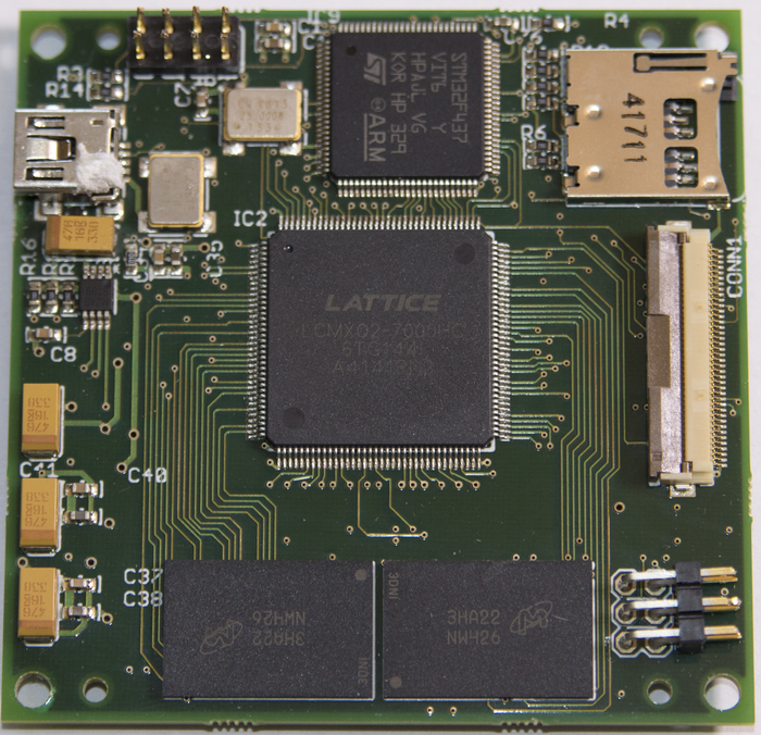

Quick reality check :
Flash memory is a Micron MT29F128G08AMCABH
Only skimmed the datasheet, but a quick reality check on write speeds :
350uS per page (8192+448 bytes), 2 planes per die, 4 dice per device, 2 devices = approx 395MbytesMBytes/sec.
VGA 640x480x840fps=258Mpixels/sec
So in the right ballpark, probably with some compression

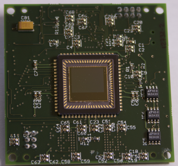

Looks like sensor is Onsemi Python

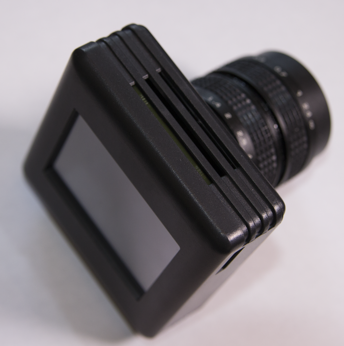

I'm concerned with the lack of sharpness that is apparent in all the example videos.  He claims it's not an inherent limitation of the camera but just down to his photographic skills.  But since he designed the entire camera that doesn't really put me at ease.  Also, all the videos look soft in the same way.
Most cameras do a lot of post-processing to produce "nice" images - could be there isn't any of that (yet) and/or there is filtering to do noise reduction - remember thet exposure times are very short....
The image looks rather soft, so the lens could be "soft". It seems that this camera takes C-mount lenses and the one fitted is probably a cctv camera lens, so nothing special, just cheap. Another factor is the aperture used to capture the video. Less light means wider aperture, which means shallower depth of field*, but also - usually - softer images. All lenses have their best sharpness at a specific aperture and there is an ideal range of apertures. Wide open apertures generally give softer images. Who knows, it could be a lack of skills combined with poor optics and wide aperture. The good thing is that there are definitely good lenses out there; the c-mount to eos adapter gives even more choices.
* So, a narrower in-focus range.
Online mikeselectricstuff
  • Posts: 13971
    • Mike's Electric Stuff
Re: fps1000 - "low cost high speed camera"
« Reply #5 on: October 10, 2014, 05:28:07 pm »
If you read the comments it seems these are not particularly optimal & he's promised to post more soon.

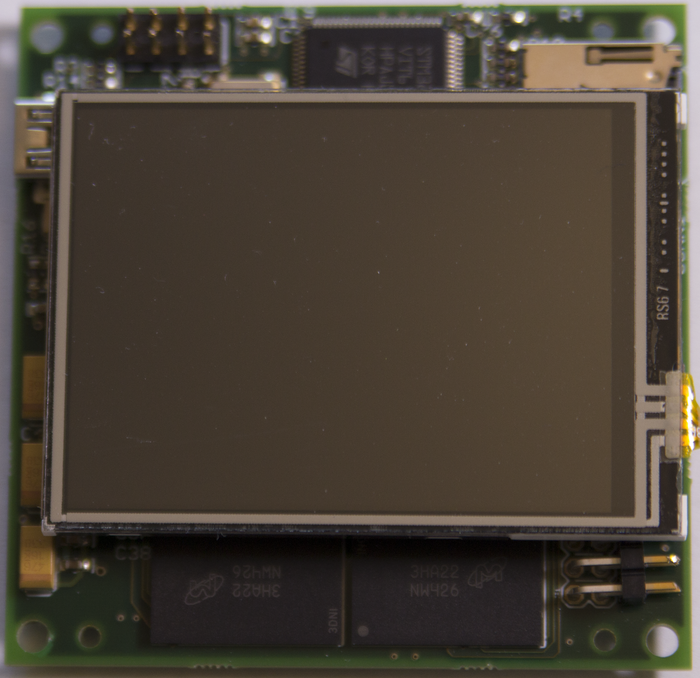

Offline marshallh
  • Posts: 1462
    • retroactive
« Reply #6 on: October 10, 2014, 05:54:48 pm »
Surprised to see a piddly MachXO2, expected a ECP3
I have not seen such high density dram before.
Board layout is obviously done in Eagle (bleh)
Surprisingly simple unlike hte previous Edgertronic camera that was on kikckstarer (7 series xilinx, SoC CPU , DDR3 SODIMM etc)
Verilog tips
BGA soldering intro

« Reply #7 on: October 10, 2014, 06:08:09 pm »
It's NAND flash, not DRAM.
The data rate isn't a huge issue in this application, it's more a case of sustaining that rate over a significant period. With this flash, it has multiple planes and dies, plus a large page size so as long as you have a moderate size fifo, the flash write time becomes acceptable.
I suspect they pre-erase pages before starting - it would be interesting to know if achievable rate drops in post-trigger mode.

There have been very few generally available sensors - most specialist high-speed camera companies roll their own (possibly adapting existing sensor designs for fast readout)
This is a new range, AFAIK the first new high speed sensors to appear on the market for many years, and are cheap compared to others previosuly available - prices from  Findchips , at MOQ of around 40x
   PYTHON 300  (VGA)   $58.49
   PYTHON 500  (SVGA)  $72.49
       PYTHON 1300  (SXGA) $117.44
NOIP1SN2000A-QDI  (presumably the  2560x2048)    Eu230

Some data on the sensors :
http://www.onsemi.com/pub_link/Collateral/PB_NOIP1SN1300A-D.PDF
I think that part is a follow-on/replacement for the older IBIS5-B-1300 device, which dates back to Fill Factory, which was bought by Cypress (and then the principals left to form CMOSIS), then Cypress sold their entire imaging division to ON.
It's easy enough to drive.
