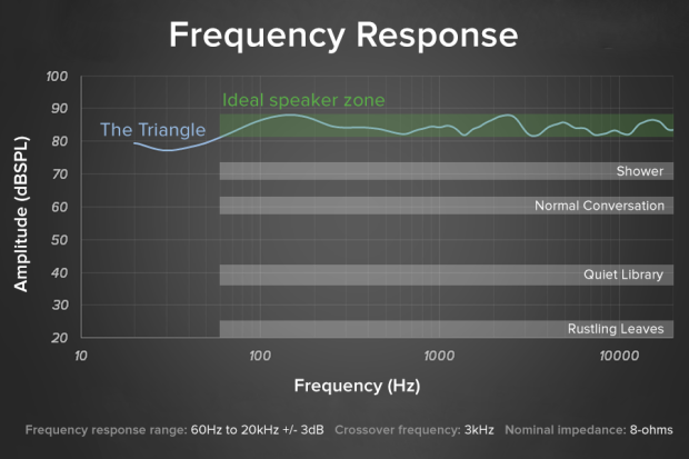

Anyway, here is some more technical figures, if you are still interested:
- frequency response: 60Hz to 20kHz +/- 3dB (60-3k on the 4" mid-range driver and 3k-20k on the 3/4" tweeter)

So, nice shiny pictures show that the contraption is paper-thin and at the same time has almost flat frequency response from 20Hz to 20KHz..
Thus, it doesn't need boring stuff like big padded inside boxes and phase inverter tubes ? Am I right ?

« Reply #16 on: June 12, 2016, 05:34:55 pm »
This graph shows everything that's wrong with crowdfunding.  The meaningful data is squished into a tiny part of the scale, with the purpose of making the product look better than it is, to the ignorant.
