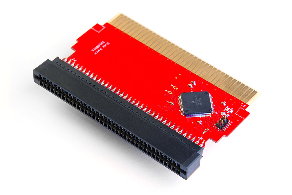

The second piece, the game patch board, is necessary because modern TVs have considerably more latency on their video inputs than did old CRT TVs. Whereas CRT TVs would display whatever signal was being sent to them virtually instantly, LCD TVs typically add somewhere between 16 and 100 ms of lag between when the signal is received and when the resulting picture is displayed on the screen. Duck Hunt assumes that there will be basically zero lag, but when there is lag, the game is already well past its shot-handling and hit-detection code before the relevant special images are even displayed on the LCD screen.
I patched the game to accommodate a variable amount of delay, effectively rewriting the entire shot-handling and hit-detection modules of the game and adding an auto-calibration feature -- about 10% of the game code overall. The emulator FCEUX was invaluable for this, since I obviously was just patching the binary (no source code). Once the patched game was debugged on the emulator, I moved it to a EverDrive flash cart, and finished up debugging on a real NES with a real LCD TV.
I knew I couldn't distribute the game itself, so I created a board that would go between the existing Duck Hunt game cartridge and the NES and would apply the patch on the fly. Kind of like a Game Genie, but much more advanced. Although the obvious path for that would be an FPGA, I chose to go with a fast ARM Cortex-M4-core 5 V microcontroller made by NXP. That microcontroller is fast enough to check the address on the cartridge (or really, the NES system) address bus, determine whether a patch should be applied, and present (or not) the patched data on the NES data bus in considerably less than 1 NES CPU cycle. Since I could execute only a few dozen instructions in that time window, I had to be very careful about programming, and most of it was written in ARM Thumb-2 assembly.
The other big challenge with the patch board was procuring the requisite 72-pin female card edge connector, since Nintendo used a 2.50 mm pin pitch on their game cartridges instead of the standard 2.54 mm pitch, and the cumulative error would cause pin shorts.
Here's a photo of the patch board, which fits inside the original game cartridge along with the original game PCB:
