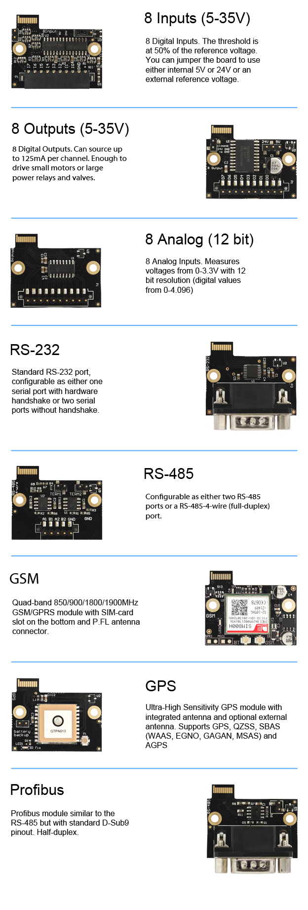

I like the idea, and can see it being useful for some of the projects I do.  It needs an RTC module (well the RPi does...).
A few missing pieces of info, such as max comms throughput, and most importantly what happens if they don't reach their goal.

As you have probably seen on the indiegogo-site already, Kean, we took your questions to heart and put them in the F.A.Q. More updates coming soon!
About the flexible funding: The RasPiComm+ is finished, so we will start even if we do not reach the goal. Why back our campaign anyways? You'll help us out a lot with financing serial production. Apart from our gratitude, you will receive a substantial price reduction and have your RasPiComm+ in hands before it's available on the market!
The RTC module is included on the RasPiComm+ mainboard - you just need to insert a battery. No more time loss when powering down the RPi
About the comms throughput: We have tested the RasPiComm+ with 4 modules simultaneously with 115.200 baud.

Hello Rainer, I am about to receive my first RasPi in the mail in the next few days, a B+ model, so I had a look at your offerings.
It appears some of your design group has a background in industrial networking but I don't see a Can 2.0B module in the list. That is the protocol that I am interested in having. Second issue is this was obviously intended for the original B Pi and not the B+. I hope you are planning a follow on mainboard for the B+ which uses the extra pins intelligently or passes them through. Finally I would like to know about the STM32F you are using, you should quote the part number. This micro family is my favorite right now. Particularly I wish to know if a SWD/JTAG header footprint is provisioned  so that the user can solder one in. Additionally I would wish to run Chibios and port your software to it and have available all unused micro pins brought to an external connector.
Yes I am demanding but without the above feature set I am not interested in anything you have now, so I won't post this question to your Indiegogo forum. You have permission to cut and paste my question there and your answer if you want.
The Can-Module is one of the modules on the roadmap, along with 1Wire, 16 isolated I/O, stepper motor module, KNX, 433MHz and a few others. These will not be available at launch, but are WIP.
The RasPiComm+ is designed to work with the B as well as the B+. A lot of people are still and will continue to use the B, we do not plan to sacrifice the compatibility with it by using the B+ GPIO header length. The RasPiComm+ does not need those GPIO pins either, but you can of course adress them directly or use them for another extension.
STM32F103RCT6
There is a development header module available.
We don't support Chibios at the moment, CPLD and STM drivers are open source whoever. If you have the knowhow, you can port them. Heck, you could design your own modules and write your own CPLD/STM code if you want to really get into it.
