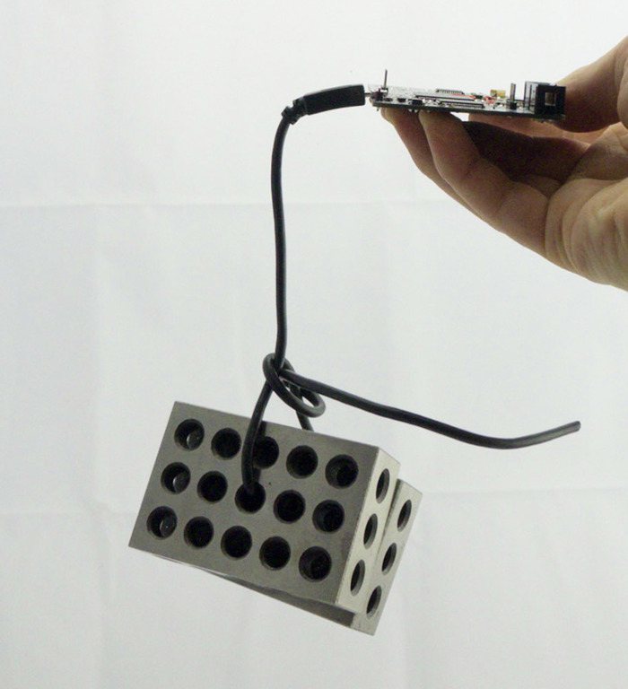

I like this picture. Mechanical strength of SMD USB connectors is often ignored and they get peeled with moderate force.
Interestingly it seemed a lot of people don't use the through-hole/SMD combo parts. In this case I'm using one of those, which gives me a lot more mechanical strength. The prototype boards have worse strength than the production versions will have, since I haven't used proper plated slots for the legs (they are rectangular legs), just large holes that fit the legs, but with tons of extra room.
There's a slight cost increase in the production run by adding the through-hole aspect, but considering how annoying it would be to break off the micro-usb connector it's well worth the minimal extra cost!
