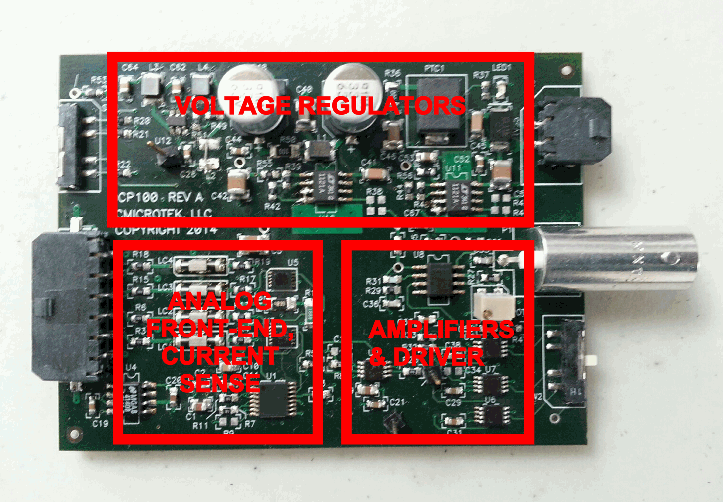

This is the µCurrent Probe PCB
I see 4.99ohm and 4.99K shunt resistors. But the chip numbers look to be rubbed off or photoshopped out.

Offline HackedFridgeMagnet
  • Posts: 2034
Re: µCurrent Probe - CMicrotek : Ultra-low current measurement tools
« Reply #15 on: February 27, 2014, 03:02:41 am »
From the photo:
On the analogue(US product) front end.
what are the devices with references LC1-4 ? are they single device LC filters perhaps? Anyone know.
Does it do two lots of current? Why 4 inputs. maybe different ranges?
Not important, just wondering.

From the screen shot:
It looks like two separate channels are being used with the two shunts, but in series (perhaps externally wired like that?) on the same current signal.
You can see that trace two is measuring the same signal as trace above it, but is allowed to go off full scale.

Really confusing campaign. My understanding of low power electronics was that it enables battery powered equipment, not that they save the planet (in the end batteries are a necessary evil). If we want to save the earth from CO2 gasses, then we should probably all stop driving a non-electric cars and stop using coal or gas in power plants.
Moreover, I don't think much people will do a low-power optimization cycle for anything non-battery powered, unless there is a heat issue. However, heat issues are often resolved with better cooling.
The "power analyzer" looks like a very similar to a project I am working on: https://www.eevblog.com/forum/chat/what-are-u-working-on-right-now-%28electronics-related-and-with-picture-please%29/msg331101/#msg331101
Shunt is 10 ohms (0.1%). I use the AD8253 INA, which is programmable gain 1-1000x (per order of magnitude).
At 1000x gain I get 50nA/LSB. At 100x gain I get 0.5uA/LSB. The AD8253 has 4MHz -3dB bandwidth of 550kHz at G=100. The noise (because I forgot an anti-alias filter  :palm: ) is about 10LSBpp. So 16-bit / 10LSB = 12.7bits roughly usable bits.
INA gain error is typically 0.04%. As the shunt is 0.1%, and I have a resistor divider (0.1%) to connect the front-end to the A/D (which is a bit of a pity to throw away so much gain), I get roughly 0.24% DC accuracy.
Unfortunately the MCP3911 has a PGA gain accuracy of 4%, and it's auto-zero feature (which can't be turned off) screws the offset cal up every reset. So it has to go in Rev2.
However, it does work:
https://dl.dropboxusercontent.com/u/207647/PA/330k%20ohm.png
Connecting a 330k ohm resistor (3.3V rail) at 1000x gain over 10R shunt. Nice 50Hz pickup / body resistance. No filtering done. I still think this image is quite noisy.
100x gain is probably the most usable range.
https://dl.dropboxusercontent.com/u/207647/PA/Noisefloor gain 1000x.png
Noise "measurement" at 1000x gain. 0dB = FS(1300uA).
Not sure whether I should open source this project. :-/O
Anyway, I really wonder what kind of performance this probe/analyzer achieves. It says it has a dynamic range of 1:40000, which sounds to me 15+ bits of resolution, but at the same time the DC accuracy is 2.5% (order of magnitude worse than my power analyzer, or several orders of uCurrent Gold).
So 1:40000 is way overkill for an 8-bit or 12-bit scope resolution measurement, but at the same time measurements can be off by 2.5% for a multimeter. :-// Am I missing something?
The picture shown could be from a single low-ohm shunt, but with different gain front-ends. You can clearly see the noise at the microAmp graph, not so much on the mA chart. So as one clips you can view the other one for a large scale picture, and use the other for low-current measurements.
That's how I do I think for such a logger. Overload recovery on the high gain amp would play a role, but if you sample both at once you can get a good overview of large dynamic range stuff.
You are still limited by the trade-off on the choice of sense resistor and usable gain though. I think the Mooshimeter tries to use a 24bit ADC, but ultimately only has 2uA resolution.
