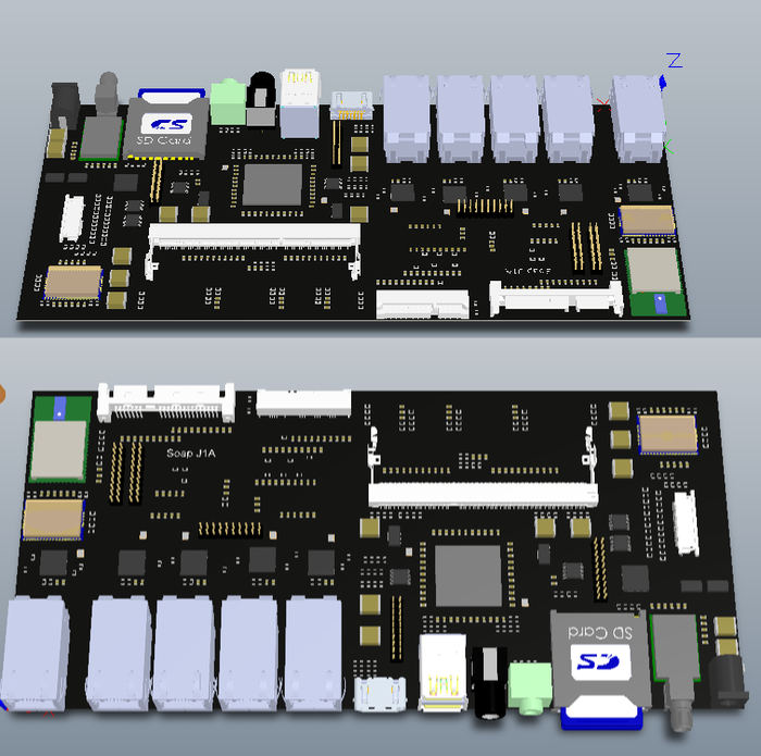

I like their current claimed board design.
Let's count the fail:
- No mounting holes for the board
- SATA male connector, which needs a completely non-standard female-female data+power cable.
- mPCIe socket next to that, hanging off the board. No mounting holes for the card that goes there.
- Two radio modules but no antenna connectors for them
- Another radio module with a single SMA connector - but this is supposed to be a MIMO router
- No Ethernet switch chip - instead they have a PHY for each connector, but nowhere for that PHY to connect to
Nevermind the random rows of passives and general BS smell of the layout.
And their explanation for why they used to have the ripped off Novena screenshots is just gold:
We originally had a opensource board called Kosagi as our foundation for our final design but we changed this when cost was too high and it had to many features that we didn't need.
We have now updated the project with our new and most recent design below which is not using any opensource source files to build (like a Altium from Kosagi)
"A Altium". Right.
Edit: more lies:
That's this board: http://www.friendlyarm.net/products/tiny4412
Note the absence of SATA or a 12V power rail, and yet they have an HDD hanging off to the side...

I mentioned the PCB didn't look right but there's more.
- I see them mostly using large format ceramic caps which are really expensive.
- And they don't have any easily visible clock/xtal for the processor
- If they use the i.MX don't they need the i.MX power/reset controller with the various core supplies?
- Amusing random headers in the middle of the board no idea what they do.
- Insufficient clearance for the SATA header to install a HDD and miniPCI card unless extension cables are used, pricey.
That they do have - I think the small grey squares are supposed to be small SMT xtals. There are two near the CPU and one next to each ethernet PHY.
It's not even the right connector for that - it's male, that needs a cable no matter what. It'd have to be female to plug in directly to a drive. Not that that would work with their claimed form factor anyway. But then again, neither can the miniPCI card.

That SATA header as you're calling it is a CFAST connector [SATA version of CompactFlash] The data signals are in the right order, IIRC, but the power part of the connector is mapped differently, with different voltages.
It's not CFAST. This is CFAST:
Note how the two slots are flat, while the wafers on the 3D render have a lip. It's just a SATA connector, of the kind you'd find on a drive:

Whups you're right... I did not notice the lip/key in the rendering earlier, thanks for correcting me.

Still sounds bullshitty to me. What are those symmetric groups of components you can see four times on the bottom side and once left from the mPCIe slots? Looks like a crystal oscillator with some diodes and capacitors around, but it doesn't make sense to have this five times randomly spawned around the board. And why is there an unequipped place for THT crystal next to the clock battery? Also, I don't see any connector for the LCD and the layout doesn't correspond to the layout of connectors in their previous 3D render (then why did they do it?).
I have been looking for any 802.11ac mPCIe card with Marvell chipset and haven't found one (after some Google searching nor in this list: https://wikidevi.com/wiki/List_of_802.11ac_Hardware), they plan do design their own?
Yeah, and the component prices still don't add up to their retail price, that's right. Still won't believe until I see anything real that's really working.
If you're talking about what I think, then in the 3D view they surround a QFP/QFN IC with a large thermal pad - maybe ethernet transceivers or DC/DC converters?  If ethernet, then they are weirdly positioned.  I see 4 very similar on the bottom, and one that could be the same on the top?
Also, at first I suspected the footprints that look like SMD crystals at the edge of the board next to the outer mPCIe slot were for the quad antenna connections, but surely they would come directly off the mPCIe module via u.fl connectors.
Yeah, where is the LCD connector?  I only see HDMI.  Surely the final prototype has to verify the LCD, if not the other unproven features like the audio and backup battery power.  They also seem to have misplaced some of the other wireless modules previously visible.
They did say they were subsidising the cost of the KS devices - but why the hell would they do that???  Get a working unit on the market, and you can sell your first batch of super duper routers for a huge premium to all those people who must own the latest and greatest, who cares the cost!  Most likely they'll run out of money getting a partially working prototype and never deliver anything.
And even worse they're now using a third party SOM, which can only be cost effective if they've realised they will only making a few hundred units.
AND YET THEY'RE SELLING THEM AT A LOSS!
They also say
The SMA connectors are not on the board. We are going to run antenna wire from the case to the WiFi chipset. THis doesn't change anything for you guys but allows our EMI to pass with flying colors
Wow!  Pretty confident aren't they!
Most WiFi routers I've pulled apart do this anyway with short coax cables between the chassis mount RPSMA and PCB.
And this is a completely different connector layout to that of the earlier "production" housing renders, so any emmissions test results on this board aren't particularly relevant to a final production PCBA.
All that said, if they had shown this "prototype" early on in the KS timeline they might have got a few more belivers, rather than showing photos of Arduinos and silly low end ARM boards with faked SATA connections.  I will be very surprised if the iMX6 and Android bloatware environment will ever meet their stated throughput goals, but had I backed this project for more than $1, I'd only be doing it for a nice HA controller.

Oh, and I forgot - they've got one of the large electrolytic capacitors placed on top of a bunch of SMD passives (near the HDMI connector).
Maybe just a slip of the mouse during 3D mode in Altium... I know I've done it.

I think that the Soap team totally underestimated the project and overestimated their skills. I wouldn't be suprised if their last project was something with an Arduino  >:D
