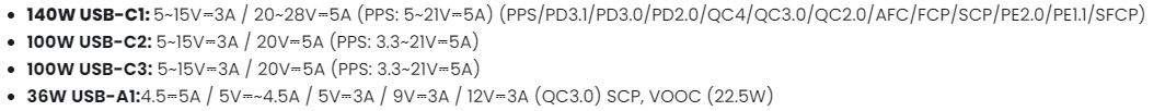

As with most multi-port chargers, the 270W spec is across all ports, not a single PD port. The Zeus is spec'ed at 140W for one USB-C port and 100W for the others.
