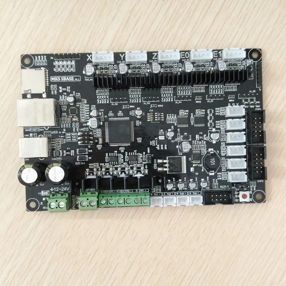

About the MKS SBASE: it is a cheap board but the documentation is kind of crappy and support I think you can forget about. I've heard some good stories about smoothie support.

I don't thing that making the board and buying the components you can do for less than 49 USD there have a lot of expensive parts ( specially in low volume ), I'm more included to buy the MKS since it's based on smothie 100% compatible, ok they have that "chinese appearance".... but who cares justify the price because works
If you plan to make the board you will also need a stencil to make a decent soldering on the board with reflow or hot air and will be very hard to be near the price of a Mks board.
Another possible path is to use arduino due, and external motor drivers, with a due version of smothies, My opinion at this point in time MKS is the the best bang for the buck to be in smothie world
