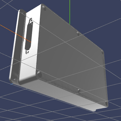

Fusion is very complex. I've successfully managed to view the product from various angles, choose which parts to show/hide, export STEP, upload to PCBWAY, and now waiting for them to review it. 2 3D printed samples for $55. Not bad!
It says "under review" so presumably some human there needs to look at it.
$100 each for aluminium, CNC. Rather more impressive pricing for titanium ;)
For metal versions I want threads tapped and for that I need to generate drawing(s) from Fusion...
I've just realised they well might 3D print it with the lid in place so I can't get inside, so I messaged them about it :) :)
you can specify if you want a fully modeled thread, which can then be 3D printed.
I think that is if I have my own 3D printer. AFAICT if I export STEP, to a printing/CNC firm, they can't do threads unless they get a drawing.
If you want to send a file to be 3D-printed, just directly export the surface geometry with modeled threads as an STL. You can easily do that in Fusion by right-clicking on the body you want to export and selecting "Save as mesh".

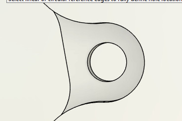

Fusion gets 10/10 for opaqueness. Just spent a couple of hours watching tutorials etc trying to work out how to change the diameter of a hole. Yes, a hole!
I can add a hole somewhere, add fillets, etc but cannot edit an existing hole. I wonder if there is a locked mode, or perhaps somebody created a hole as a "negative" so there isn't actually a hole there?

The normal process to edit a hole is right click on the hole and -> edit profile sketch. If that hole was created by a pattern feature or something else you might have to find its origin, and edit that one.
Its also likely the file was imported as STEP and it does not have any feature data embedded in it. Look at the bottom timeline and you'll see timeline history, if there is nothing then you can't edit feature data that doesn't exist.
In that case you start a new sketch on top of the hole and draw a larger hole to cut it bigger.

I tried it but cannot find an editable hole :) Clearly it is more subtle... but this is an extremely complex program, with loads of "selection" modes.
The drawing was definitely done in Fusion. I have the .f3d file. If you import IGES then AIUI you get no "objects" that can be edited. No doubt that's why designers only give IGES to their customers, forcing them to go back to the designer for any mods ;)
Just because you have a f3d file does not mean it was made in fusion, or contains any feature data.
You can import a step file and then save it as .f3d.

I still cannot edit the hole :) I can measure its diameter using the Measure feature. I can also add new holes elsewhere. But jc101 above can edit the hole OK.

You can just close the hole using direct modeling tools. Or create a sketch on the surface with a circle covering the hole and then extrude.

I got the 3D prints back from PCBWAY. Very impressive!
