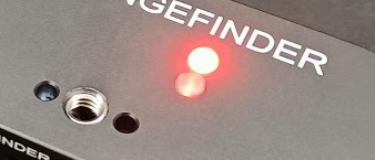

Hello,
kindly check the image here.
I am interested into learning how to mount LEDs on front panel like this and which part from Digikey can be used? I know he uses PCBs as front and under panel while the design PCB itself (green color) is in between..
more pics from here: https://www.axunworks.com/product-p341706.html
thanks

This is just standard 3.5 mm LEDs mounted on the green board and poking though the top cover.
There is nothing like this that can be used with a single board and with an actual lens. But if you are ok with just a hole in the top panel PCB and light shining though, then you should search for  reverse-mount LEDs. Some of them are flush with the mounting surface, some will sit in the hole and may end up being flush with the panel surface.

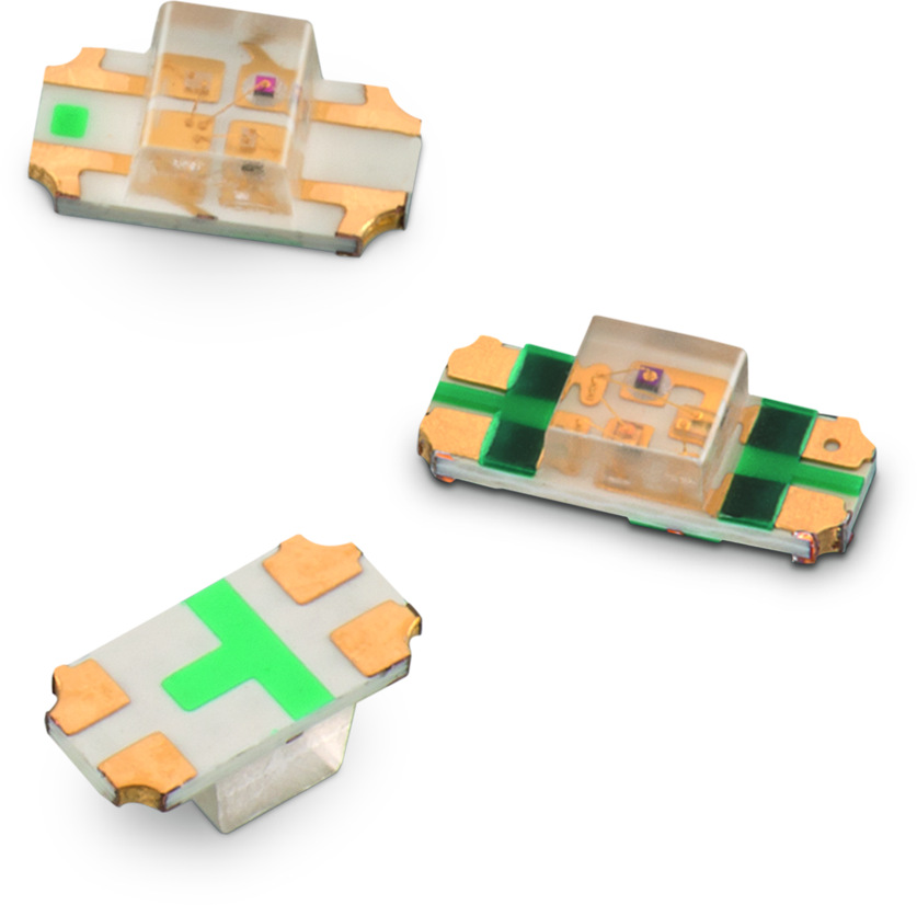

Basically this https://dammedia.osram.info/media/img/osram-dam-2711021/s,x,760,y,0/00142087_0.jpg or this https://www.we-online.com/catalog/media/o135755v209%20Family_WL-SFRW.jpg
Although some seem to be more attractive, may be even suitable for direct use without additional lenses https://www.digikey.com/en/product-highlight/s/sunled/1206-reverse-mount-with-inner-dome-lens

Mounting TH LEDs like this is an annoyance in terms of production (if you have any kind of production to do, now if it's just prototypes, who cares.)
Usually easier to use SMD LEDs and light pipes to guide light to the front panel. Like this: https://www.lumex.com/lightpipe.html

In your original photo it looks like they are using standard 3mm through hole LEDs, and I suspect they have LED spacers in place to avoid the LED getting "pushed in".  Common suppliers of these spacers are BIVAR and Essentra.
If you are making the front panel with a PCB, then it makes sense to leverage that and use reverse mount LEDs, and use appropriate length board to board SMD connectors.  You really don't want to be soldering wires between boards as that removes any assembly advantage of the reverse mount LEDs.
You need to work out the trade off between soldering some through hole LEDs vs SMD assembly of a second PCB.  Using an actively connected PCB for the front panel can certainly give you additional design options like capacitive touch buttons or better shielding.

Reverse LEDs can be nice but you get crap in the hole and the LED gets blocked... As someone else suggested, get the PCB host to route most the way through the FR4 and use the last layer as a defuser. If done right, it looks nice. But not very bright. Good luck with that in daylight.
Offline VEGETATopic starter
  • Posts: 2012
  • Country: jo
  • I am the cult of personality
    • Thundertronics
Re: How to mount LED in a product front panel
« Reply #21 on: November 04, 2022, 10:51:09 pm »
sticking light pipes is another problem as well.
by reverse leds i meant those which can stick out to be flush with the board. so I can dig a hole in pcb to fit it.

Quick comparison for 100 boards:
Board to board connectors mentioned above + reverse LEDs = about 180$.
SMT LEDs + light pipe I mentioned = about 160$.
is this ok or am i missing something?
