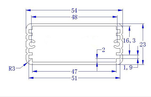

Offline ebclr
  • Posts: 2331
Re: Looking for low-cost suppliers of extruded enclosures
« Reply #5 on: October 22, 2017, 03:55:47 pm »
This box cost 2.12 USd in china
