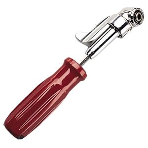

Offline ndictu
  • Posts: 211
  • Country: sk
Re: Screw Mounting Holes - How far from board edge?
« Reply #13 on: January 29, 2012, 09:00:59 pm »
skewdriver
Probably wouldn't fit. I have Noctua NH-U12P, which isn't even that big compared to some modern ones.
(Not my picture, random google search)
I have something like this and it works:
