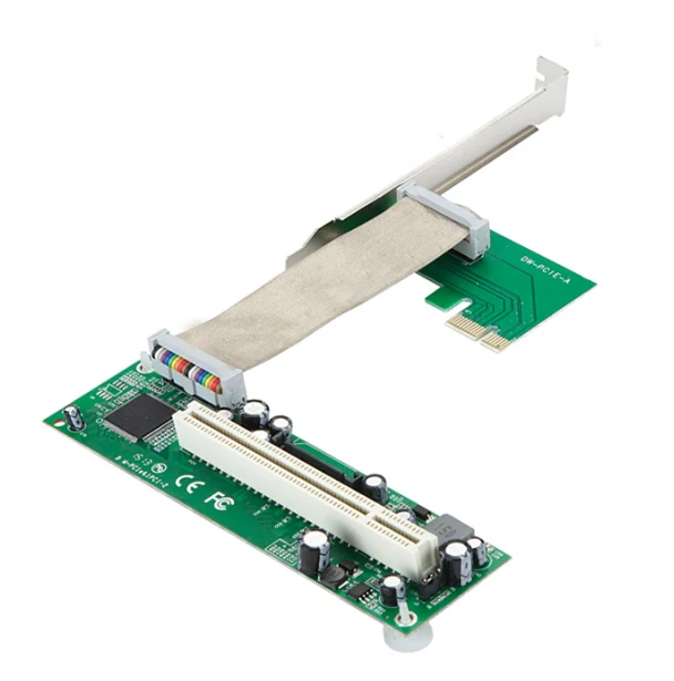

I'm not familiar with the latest stuff, but there certainly used to be PCI slots on AM3+ boards taking AMD FX 8-series and DDR3.
Another thing that exists is PCIe x1 to PCI bridge cards. They only take low profile (about ⅔ width) PCI cards when mounted normally, inserted into a slot at the back of the case. But you could plug the bridge into a PCIe x1 riser/extender employing USB3.0 cabling and then mount it in some nonstandard location. Maybe somebody makes ready-made external boxes for such thing? I imagine there may be quite a few people with exotic PCI devices who would want to keep using them.
Offline adrifromhhTopic starter

Why not using a PCIe to PCI raiser card?
It needs a PCI-e to PCI bridge IC as well.

While rare such boards are definitely out there. This is mostly thanks to PCIe to PCI bridge chips. These chips allow motherboard manufacturers to stick a oldschool PCI port onto pretty much any CPU/Chipset since they all have PCIe available no mater how new they are.
I have seen these PCI/PCIe bridge chips used even on PCIe cards where the card was originally PCI but then the manufacturer deiced to update it to PCIe by simply adding the chip to convert its PCI based chipset into a PCIe bus so that it fits into that new PCIe slot.
You can also buy PCIe to PCI adapter cards that have a PCIe card edge, feed that into the bridge chip and then have a PCI socket sticking out of it. You might have to get creative mechanically to make something like that fit into a standard PC case tho. But if you have a miniITX board in a full tower case there should be room underneath the motherboard to put the bridge PCB and you can use a cheap PCIe extender cable to reach the motherboards slot.

https://www.aliexpress.com/item/32831287730.html
Thanks! I didn't know such thing existed. It even has "support for innovative sound card"  ;D
