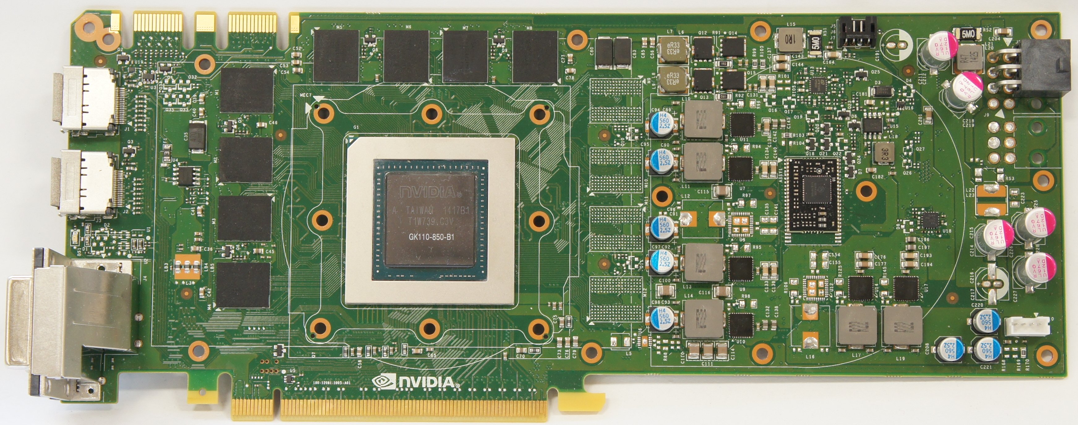

Hi There!
I just got a Quadro K5200 from Ebay. it loooks like this:
Do you think if I manage to solder properly (I know it is BGA so bla bla...) those missing 4 1MB chips and hack the ID... I will then have a K6000?
Should I try it?
EDIT: I think there is also some work to do at the power supply part... bummer.

« Reply #1346 on: December 19, 2017, 03:58:48 am »
That little auxiliary board looks interesting. What chip is on there? I can't quite read it in the picture.

« Reply #1347 on: January 09, 2018, 06:59:10 pm »
I doubt it, its missing more then just the RAM, an entire power phase is missing, likely for the extra RAM.
