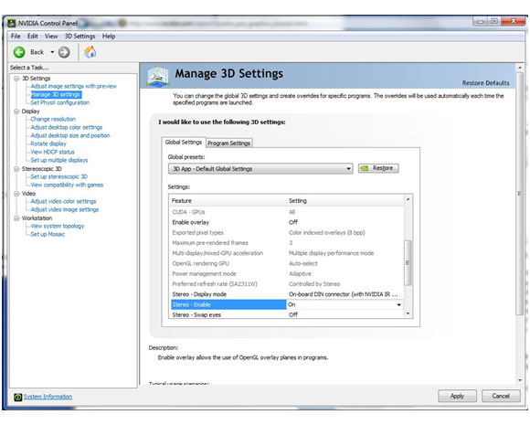

Offline Mikhail80
Re: [MOVED] Hacking NVidia Cards into their Professional Counterparts
« Reply #555 on: September 14, 2013, 11:09:24 am »
Good morning, I tested successfully mod my GTX770 in K5000. How was not finding the resistors, used Trimmers 50k ohms, like these,
And I configured one for 15K and one for 40K, the board used was a Zotac GTX770 AMP!
Follows the model of plate tests and referrals. Subsequently do more stability testing. If anyone needs the bios I upload.
My congratulations!
But... dear colleagues, what's about SPECviewperf test?
https://www.eevblog.com/forum/chat/hacking-nvidia-cards-into-their-professional-counterparts/msg210155/#msg210155
If your "GeForce" and "Quadro" test speeds are the same, then there is a big question for unlocking efficiency.
Could you post your SPECviewperf test results to submit your success?

@Mikhail80:
Nobody has yet been able to restore the missing GL primitives on GeForce cards. Cross-flashing the BIOS, in the one case where it actually works (Q2000 BIOS onto a GTS450), doesn't seem to achieve anything obviously useful in this regard; then again, Q2000 and GTS450 are very, very similar, much more so than other GeForces are to their equivalent Quadros, with maybe the exception of a K5000/GTX680 4GB variants - in that they have the same amount of VRAM. I haven't tried flashing a full strap-adjusted K5000 BIOS onto my GTX680 yet - it is on my ever-growing TODO list. :(
In case of the GF106 GPUs (GTS450/Q2000) I suspect the missing functionality is cut out of the GPUs before packaging, and if that is the case, the chances of restoring this are non-existant.
Note, however, that modifying a GTS450 into a Quadro 2000 does produce some performance benefits - Maya scores, although still far behind a real Quadro 2000, go up by around 40% after modifying the card. In case of the GTX470/Q5000 and GTX480/Q6000 mods, there are also other performance improvements, to be gained, such as enabling the second DMA channel (DMA transfers become bidirectional rather than unidirectional), which can significantly boost DMA transfers to/from the GPU, depending on the workload you are throwing at it.
Unfortunately, the same improvements do not hold in case of GTX580/Q7000 mod - all results remain exactly the same on that. Other people have reported similarly unchanged results on later GPUs. There also appear to be no bidirectional DMA capabilities on the newer GPUs.

Gordan, can you check if Manage 3D settings is different with K5000 bios? It should look like this with quadro --> http://www.planar.com/media/245367/3d-ready-config-3.jpg

Are you sure this works on a genuine FX3700? I have a laptop with a genuine FX3700M in it, but I don't recall seeing any extra options in the settings compared to a GeForce 260M it replaced. If you tell me what exact options you expect to see, I can look for them and report back.
Under manage 3d setting there should be a Stereo-enable option.
I'm fairly certain it should be there. Your FX3700M might not have it unless it has a stereo connector or you have a 3d vision unit with approprate drivers.
There is definately something else being checked by the driver. I found an old driver patch that enables the options and page flip stereo works but at the same time the mod destroys open gl performance and playback is jerky.

@Jager, baconsteak:
I'm going to have to disappoint you - the stereo options don't appear in the control panel. It does appear on my genuine Q2000. It is possible one of the unknown strap bits have an effect, but it will be a while before I can test this.
The ECC is togglable (to no effect) on bare metal, but not from a VM. There must be some NVRAM somewhere on the card that saves the setting, but virtualization layer doesn't let it through (in the same way that BIOS access to the card crashes the host).

how is the checksum exactly calculated in there?
You can use the nvflash tool to modify the straps and it calculates the checksums for you. I'm completely noob and I managed to do it but it took me hours to wrap my head around it. I followed this guide. I'm sure one of us can help you out if you're stuck.
Thanks for the help gordan.
That sucks that nothing in the bios seems to control whether the 3d stereo function exists. I guess I will have to look for a second hand quadro with a power connector so I can overclock and still game.
