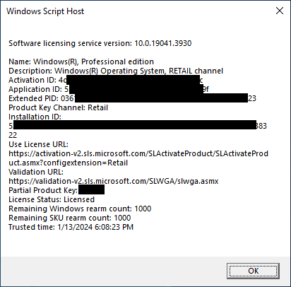

and for the ultra cheap serials you can buy,  they are mostly oem, volume ... some licences goes to a tons of pc's before being locked out of available quantity
While many of the shadier sites sell volume keys, you can still find cheap RETAIL channel keys. I've bought several. The one on the left is actually a Win10 Pro VM activated with a Win11 Pro key (yes you can do that) bought just last week from Groupon for $16. The one on the right is from my main Win11 Pro workstation activated with a key from Kinguin bought a couple years ago for $20-something. Now they might be OEM, and they might be fake generated keys, but they work. And the one on the right has survived a couple of hardware upgrades that required me to re-activate.

Just in case anyone is interested, I did a little checking and apparently the only restrictions on using Windows 10 unregistered/unlicensed are that some cosmetic changes are locked out. I didn't did much deeper. Personally I think I would find that more of an issue than the "limited time" demo mode of Windows 7.
