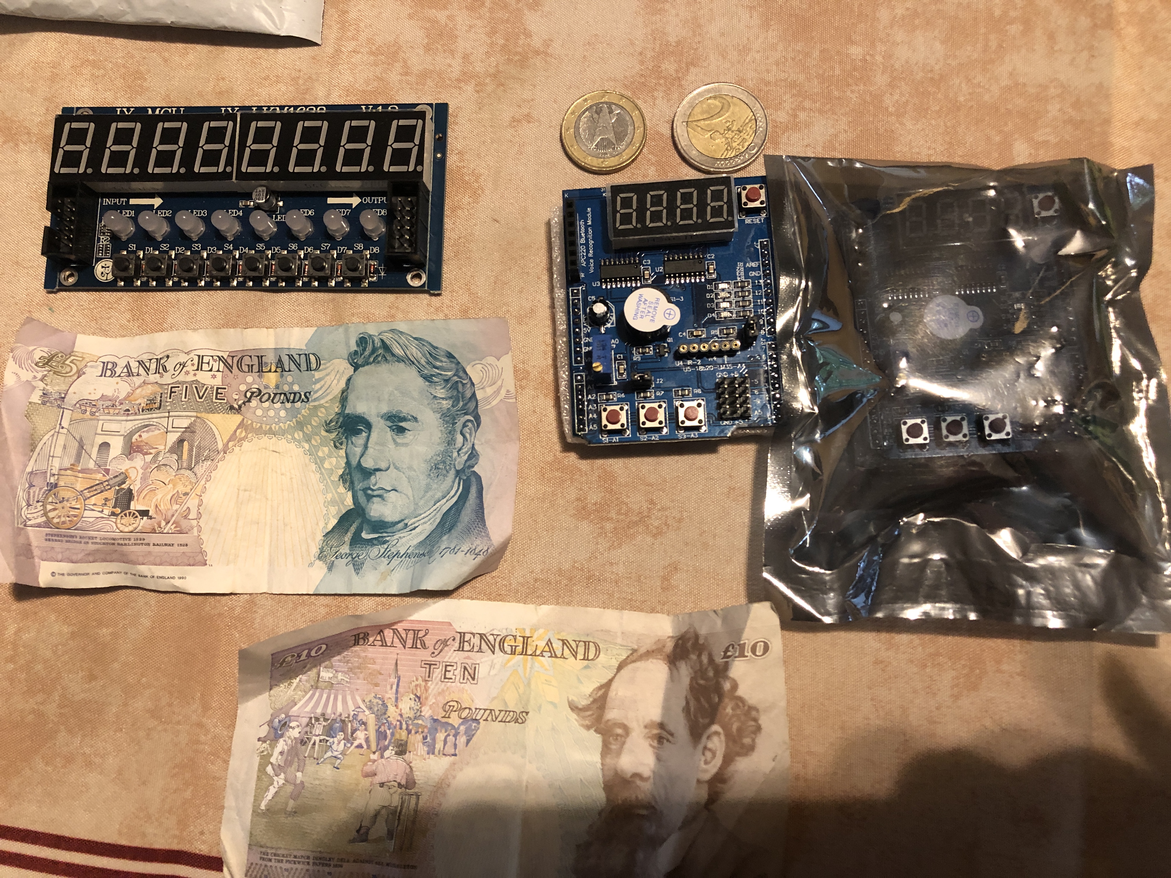

« Reply #11 on: August 24, 2019, 02:32:34 am »
@LIAMT, your PM inbox is full, so I'm responding here.
You mentioned today that you need this next week.
I know this is a rush but just seeing if it's possible.
Here's what I have on hand that is possibly workable.
I have an 8 digit, continuous display, whose total width is 10cm by 2cm for the display and 11cm x 5cm for the whole display board.
Image here: 5 and 10 pound notes for scale. 1 and 2 Euro coins also for scale. (I couldn't find any pound coins handy.)
https://s3.amazonaws.com/static-s3.sokoloff.com/random/electronics/7+segment+displays+for+film+project.JPG
With the timeline as you now have it, there isn't time to order custom PCBs and therefore isn't time to have a customized layout. The best you can do is get a trophy shop to cut out some plastic bezel or something to cover up the excess circuit board on these prototype boards (or do something similar from sheet plastic that you might have lying around)
I banged out some quick code to make it go and it should be ready for me to post out early in the week. You can then decide how fast/expensive a postage trip you want it to take.
Video of the project as it stands now: https://youtu.be/nSzxYOgwnZQ (it will be easy to see that of the two of us, I am not the filmmaker...  :palm: )
This video gives you an idea of what is possible in terms of making a bezel for it (this is not my video): https://www.youtube.com/watch?v=-_RKP6kS5j0&feature=youtu.be&t=370
Cost of parts is around $10 for the LED module, $20 for the controller, a few bucks for wire connectors and you'd end up with something that you could power off USB battery pack [that you would need to source locally]. Call it $50 plus postage (net to me after all fees) and it's yours (assuming what you see in the video is OK for your purposes  :-DD ) If there's a reasonable place to get a mention in the scrolling credits, I'd greatly appreciate that, of course. If you need me to flip the jack around so the wires come in from the back, I can do that as well.
Postage looks like it's going to be $37 for 6-10 days, and $65 for 3-5 days transit time, and $90 for 1-3 days transit time (coming from Waltham, MA 02451 or thereabouts). Fedex was quoting transit costs over $150, so either they don't want the business or think that you need this a lot more urgently than you actually do... If you have another carrier that you prefer to use (or have a carrier account that gets you discounted rates), I can use that as long as the effort is reasonable on my end.
If we had 4-6 weeks until you needed to shoot the final, I could also spin a custom PCB and get the layout however you like if the exact appearance is critical for the film. Costs there would be more like $250 all-in (plus postage) for a working programmed PCB with roughly the functionality as shown in the first video above.
But if you just need an ominous looking 80s-style LED countdown timer, I think the parts I have on hand will look and work just fine. I didn't use the LEDs below the digits display, but we could. That are bi-color LEDs (meaning a combined red and green LED, meaning they can show red, green, or yellow on each LED as you wish, but the yellow doesn't look good [it just looks red]).
Please advise any thoughts!
