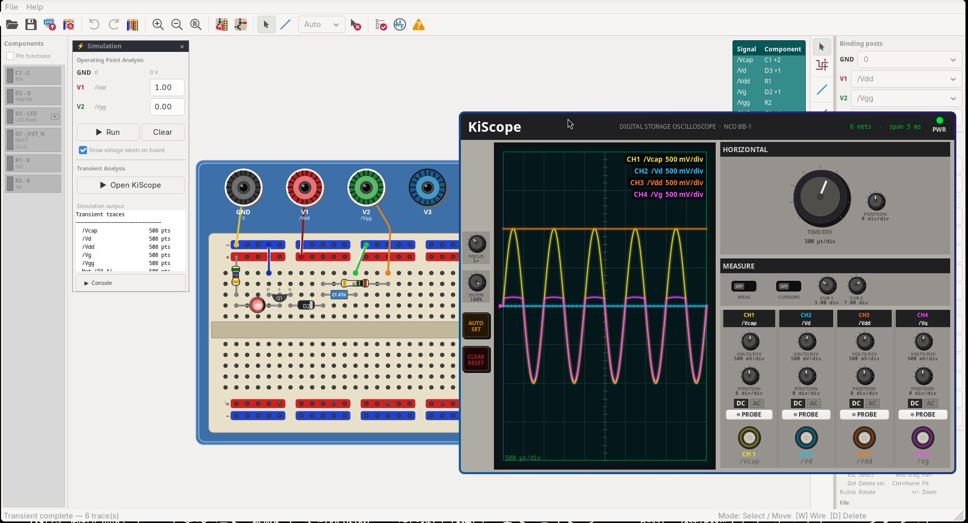

For an EE class I teach, I made a plug-in for KiCad that allows users to create a breadboard version of their schematic. Components are added to the view, after which you can place them on your breadboard and validate the build once you’re happy with it.
https://github.com/kerstensrobin/kicad-breadboard
The validation logic is a pretty comprehensive netlist check that takes into account the symmetry of basic components such as resistors. They can be flipped around in real life, but not in the world of netlists (that was a PITA).
To make it even more beginner-friendly, I hooked it up to KiCad’s built-in ngspice, so you can have either:
  • Operating point simulation: see which DC voltages can be expected where
  • Transient simulation with an “oscilloscope” visual, with knobs you can turn and settings you can tweak. It also includes some basic measurements and cursors :)

In the image, the red-blue bars along the edge of breadboard only connect 5 holes, if all the blue are electrically connected together then the blue should connect between the groups of holes, same for red. I didn't notice the white space on my new long breadboard 40 years ago and now its the first thing I see.

Well, as i can show using the nifty Net Highlighter tool: On most breadboard the 'power rail' ties are grouped in groups of five, but are connected along half the length of the board, with a broader space in the middle where the electrical connection stops. I explicitly wanted to put this in the board as this is something I see first year students often forgetting during circuit assembly.
If, when using the tool, you find this level of realism impractical, this can be turned off in the preference menu, then the rail-ties are connected all along the length of the board  :D

This is what we usually see in real life, and just like any jumper wire or schematic wire, I think the color bars should show how they are connected (like in real life), the narrow space -wide  space doesn't match reality and is ambiguous at best.  I still think its a great addition for anyone learning electronics.

There are now four styles of power rail markings you can choose from. 'bbrd classic', 'bbrd modern', 'solid line', or 'no markings'
That should cover many scenario's! :)

At the risk of bikeshedding,I have never in my 20+ years of teaching electronics seen breadboards with the power rails in groups of five (unless it's something new in the last couple of years). If you want to make it more student friendly, show it in two groups with jumpers bridging the gap in the middle, that will remind them to jumper in real life..
