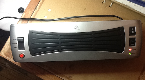

After watching this video I went out and bought a cheap laminator;  I added a simple push button to start/stop the motor so I can manually slow it through the rollers - works nice!!
