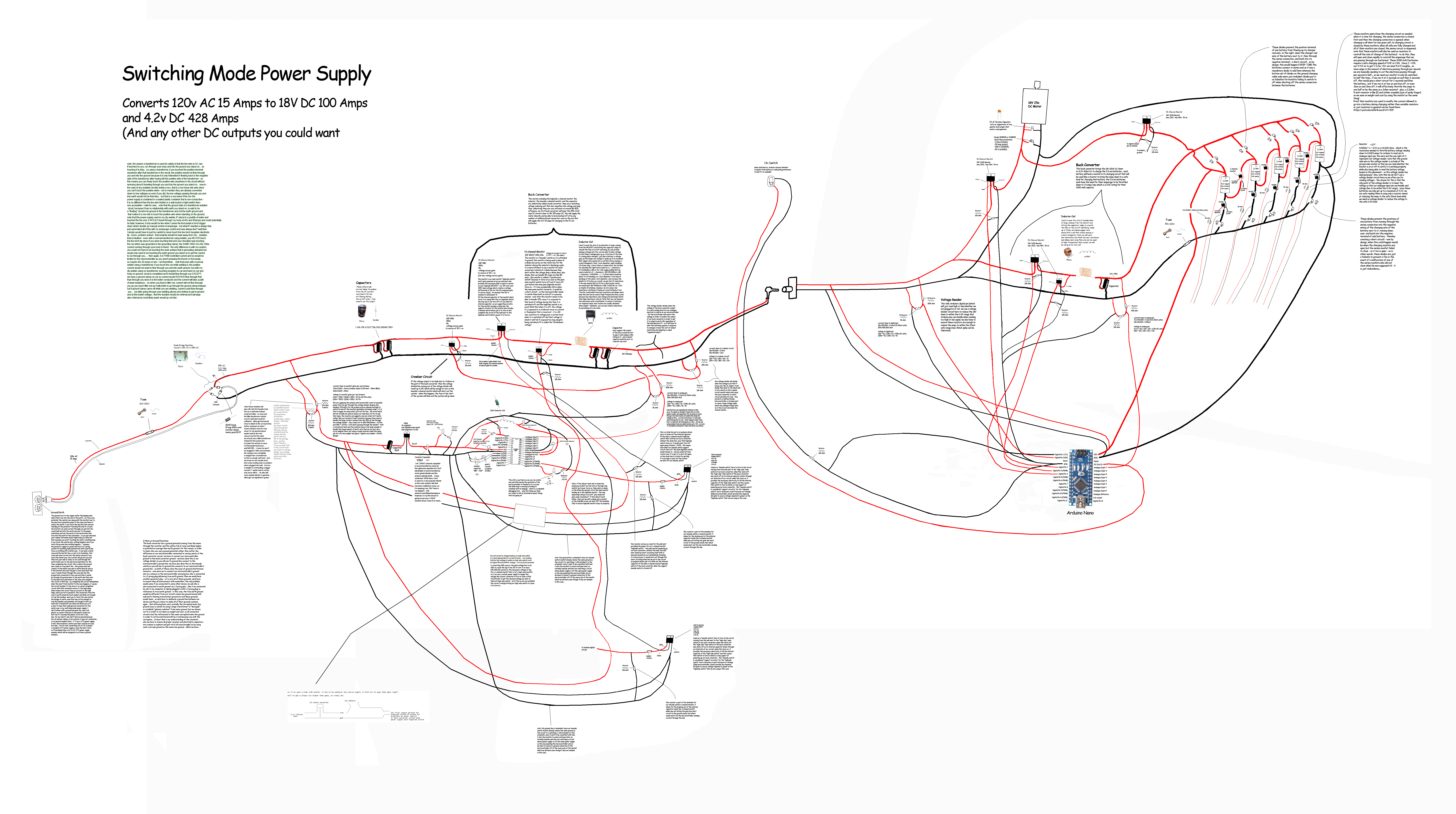

I have taken constructive feedback about 3-4 times in the past few days.  The most recent being that my highside mosfet needs 165v to drive its gate.  I thanked Andy for this.  So don't lie and say I'm not reading and considering the feedback.  I accept the feedback when it is solid.  I reject it when it is objectively false which is majority.
165V to drive a MOSFET gate? that would be 10V less than the positive rail the source is connected to.
My understanding was that the 120v standard AC input after going through the diode bridge rectifier would become 155v and so then 165v at the gate would be 10v when you probe the gate (165v) against the source (155v) due to their relative voltages being 10v difference.  This would net a postive 10v as the Vgs.  For you to say it would be 10v less than the positive rail of the source, wouldn't that mean the source voltage is 175v?

« Reply #936 on: November 11, 2024, 11:03:27 pm »
Oh dear, I've opened a can of worms. No the voltage does not become 155V having gone through the rectifier. 120V is the RMS voltage. It is a sine wave that peaks at 169.7V. You can take off a couple of volts for the diodes if you want to be pedantic and call it 167.7V but that is just the peak. If you place a capcitor across the output it will hold that peak voltage, but as soon as you put a load across it you will get some random voltage between the RMS voltage and the peak.
So the only correct way to drive a P channel MOSFET connected to such an unstable supply is with -10V relative to the positive rail, whatever it may be. If you actually produced a fixed positive voltage to drive the gate with your results would range from not working to a blown mosfet.

I have not been following the thread but I suspect that the power supply jibe is a reference to a former member who had a thing for power supplies.
Not exactly... This below (if you have strong nerves):
Why are you posting a old revision of my schematic Manul?  Proves you are arguing in bad faith and cannot be trusted.  Everyone knows I have greatly improved on that version with many revisions since then over a multi-year period as I learned more about electronics.  Here is a more recent one which I already posted yesterday and Manul conveniently ignores here as a bad faith actor:
Here's my updated switch mode power supply design.  It has changed many many times as I learn more and find my mistakes.  It is perhaps significantly different than the one that was shared and examined here earlier today.
http://artbyrobot.com/switch%20mode%20power%20supply%20copy.jpg
I was planning to use a n channel mosfet.  I don't like p channel mosfets.
I don't like them because I don't understand the notion of providing a mosfet with negative voltage and how that is done and so I view this as a pandoras box for a electronics beginner.  I like to use components that make sense to me intuitively.
« Last Edit: November 11, 2024, 11:18:27 pm by artbyrobot »
Honestly I was not paying attention, cause who cares. But thanks for reminding of the updated schematic. Everyone is free to view it and judge for themselves, how much of "improvement" there is.
That ridiculous childish schematic. In some places you put the schematic symbol in-line and put the component physical likeness beside it, and in other places you put the component physical likeness in-line and the schematic symbol beside it.
It's ridiculous to ask anyone to examine such a mess. I won't look at it further unless it's re-drawn in a more professional manner.

with 155V across drain-source, it will heat up and let the magic smoke out ASAP.
no, it's a IRF 840 rated to 500v across drain-source.  So 155V across drain-source it would yawn at.
Hmm... lets re-examine my entire sentence... OK?
Yes, with a gate voltage of 5V the MOSFET will be partially on, and with 155V across drain-source, it will heat up and let the magic smoke out ASAP.
Go back and look at that graph again. 5V on the gate means the MOSFET will be passing 6 amps or more while there is 155V across it. That's more than 930 watts of power dissipated in the MOSFET. Maybe have another look at the datasheet too...
If your voltage divider gives the MOSFET's gate 2V (Below turn-on threshold)
the 2v turn on theshold doesn't mean its fully on though and it is not fully on till 10v.  so I imagine say between 2v-6v the amount on is so partial that the current flow is minimal and can be safely ignored.  So my crowbar would be okay to let waste power as a partial short circuit while the gate is only partially open like this.  That is my theory I have to look into more I guess.
Nope. It cannot "be safely ignored"... See my comment about power dissipation above.
For a crowbar circuit, a SCR, zener diode, capacitor, and a resistor are all you really need. Google "SCR crowbar circuit"
I prefer to invent my own crowbar circuit to pave the way to more options of ways to make a crowbar.  Another upside is if I design it, it means I understand it.  Understanding what is going on is important for me.  At least I prefer it over black box.  I'm ok with black box often but not for something safety critical I guess.  I prefer to understand it.  My assumption is a SCR is a unknown.  Never heard of that acronym.  So I might now understand that.  So I prefer to not go that route as it is foreign to me.  And I prefer not to look up that google search suggestion if my existing solution works already and from what I can tell by what you wrote, it seems it will work fine.
But you don't actually understand it and that's why you don't understand why a SCR & zener is the superior solution here. If you'd actually built and tested this circuit, you'd know that.
How did you ever learn about MOSFETs? Were you as resistant to learning about them as you are resistant to learning about SCRs and other ways of doing things?

"New" schematic file edited with Photoshop CS2, timestamp 2024 11 10, 22:37:32. You made that "improvement" yesterday after hearing what people said, don't you? You posted it just after someone explained about the voltage levels. And you moved the fuse, which was also suggested here yesterday. Now you present it like it was done by you, some "iteration" of your power supply design. I applaud you.
Here is proof the fuse moving was done by me in febuary on my schematic.  http://artbyrobot.com/switch%20mode%20power%20supply.psd
So enough with your foolish false accusations manul
Also the voltage to drive it was discussed in this february one although I didn't raise it enough and now it turns out even the 165v andy suggested is too low even.  It needs like 180v according to chatgpt just now.  Since the rectified voltage is 168v-170v peak dpeending on 115v-120v input before the diode brdige rectifier.  In my last update I did in February, I knew the voltage had to be higher than 10v more like 55v but didn't realize it had to be 10v higher than the supply voltage at the time I thought it had to be 10v higher than the drain voltage which I now understand is inaccurate but I was getting there already before anyone here said anything.
You need 165V to switch on your highside MOSFET (i.e. 10V over your 155V main voltage)
Coincidence? No. Anyway, I don't believe you, so who cares.
