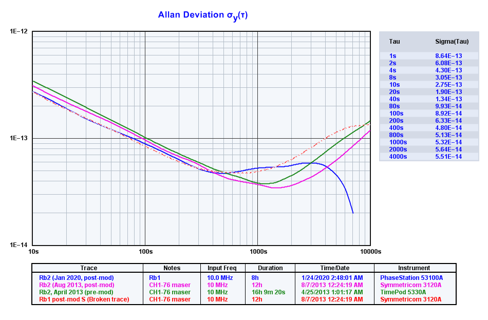

When you see a sqrt(tau) expression in a specification for a long-term reference like an Rb or Cs standard, you can usually assume that it's valid between t=1s and the flicker floor.  Essentially, they are giving you a limit mask in the form of a diagonal line with slope -0.5 on a log-log plot, suggesting that they expect the instability to be dominated by white-noise frequency variations.
In that regard, the FE-56x0 models will resemble most other small telecom-grade rubidium standards:
That sort of spec leaves out a few details -- for one thing, where is the flicker floor?  In the blue trace above, the line bottoms out at what might be the flicker floor, but could also simply represent the onset of drift due to insufficient warmup time.  However, the rudimentary ADEV spec would have met customer requirements at the time, and it may also reflect the limitations of the measurement setup the manufacturer had available.
The plot above actually came from an eBay'ed FE-5680 with a ton of hours on it, so you can probably expect yours to perform about the same.  As far as the error bars on "probably," that would be left as an exercise for the reader.
Edit: FEI's brochure is actually pretty informative, check it out if you haven't already.
Very informative post, but I am still trying to figure out how to go from ADEV to something practical; specifically how much the frequency will vary over a specified time period according to some statement of probability. "Exercise left for the reader" presumes the reader knows how to execute the exercise. So far, no one has provided an algorithm (or process, if "algorithm" is too restrictive) to convert ADEV to such a quantity.
