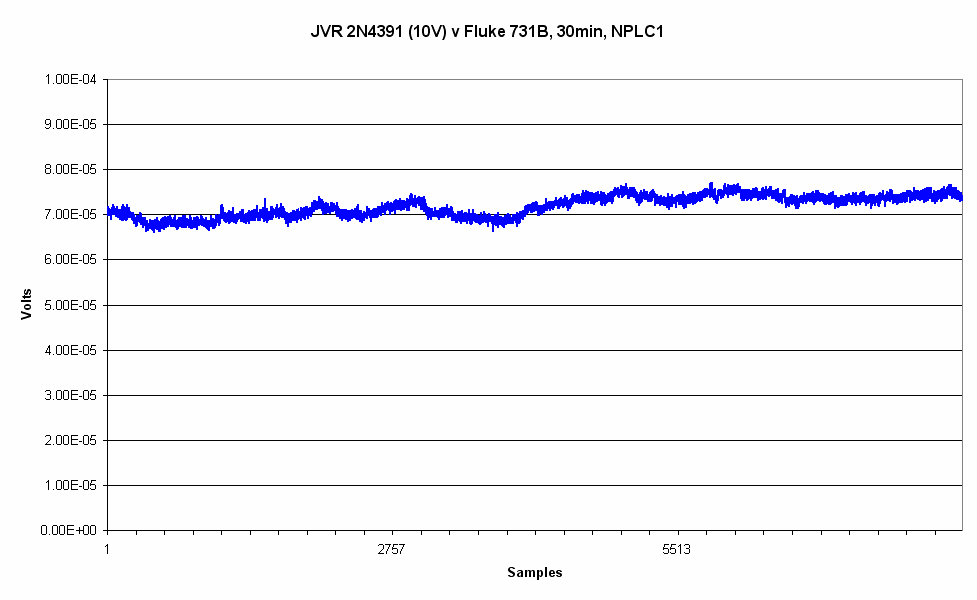

I've built the first 10V prototype with the 2N4391. The reference voltage was around 7.228V, so I've used OPA227 and some wire-wound resistors to scale it up to 10V, the same type wire wound resistors were used for the reference source as well. Without much tuning I've got around 2ppm/C and very low noise level. This is the first time I've measured the JVR against the Fluke 731B, using Keithley 2015 on 100mV range. The variations are around 1ppm, the noise is well below 1ppm p-p.
This is a step towards a properly built reference - I've used a good aluminium case, good resistors and Tellurium Copper terminals, though the circuit is built on a prototyping board.
Cheers
Alex
10V JVR on 2N4391 measured for 30 min against the Fluke 731B by Keithley 2015, 100mV range, NPLC1, no filtering, 1ppm per division:

Here is another graph of the 2N4391 JVR v Fluke 731B. This time I've used a better cable (a screened pure copper twisted pair with copper plugs which I've just received), a foam cup on the 2N4391 FET and NPLC10 on the Keithley 2015. 30min run, 1ppm per division.
Cheers
Alex
« Last Edit: November 21, 2015, 10:48:20 pm by Alex Nikitin »

Hello,
ist the lesser noise mainly from NPLC10 or also from the additional shielding?
with best regards
Andreas
Online Alex NikitinTopic starter
  • Posts: 1177
  • Femtoampnut and Tapehead.
    • A.N.T. Audio
Re: Building your own voltage reference - the JVR
« Reply #89 on: November 21, 2015, 11:19:15 pm »
Hello,
with best regards
Andreas
The noise is less because of NPLC10, however the slow voltage variations are less due most likely to smaller thermal effects from pure copper cabling and connectors. I've used just standard cables previously and at least some of the drift was due to thermoelectric effects.
Cheers
Alex
